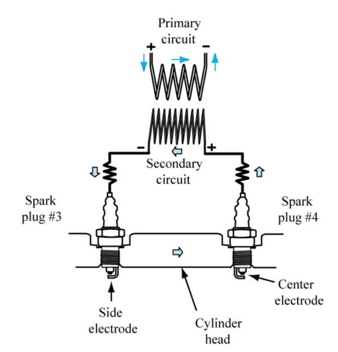

2seater Posted February 1, 2023 Share Posted February 1, 2023 I am just going to put this here in the lounge section rather than muddying a thread with this side track. This is about spark polarity in the waste spark system. I must admit it has puzzled me why my V6 Ford Ranger, with a virtually identical ignition to our Buick, has single platinum plugs with the platinum on the center or side electrode depending on which side of the engine it was on. Over a couple decades I would find examples, mostly when connecting an inductive pickup on a plug wire. Sometimes it needs to connect apparently backwards for it to work. Both things above indicate reverse flow of electrons must be occurring but how can that be if the spark plugs all connect the outer shell and side electrode to the ground or negative side of the battery? Apparently the battery has nothing to do with spark polarity in this system. Nothing jumps out when looking at a schematic of the coil and plug, at least not to me. I found this simple diagram below in a physics forum. It has small arrows indicating the flow direction of the energy pulse with the note that secondary polarity is built into the coil depending on how it is wound using the left hand rule. 😳. I have no idea what that means but at least it establishes the flow is designed into the system and isn’t random. The other piece, at least for me, was how a grounded plug could be both negative and positive; so to speak? The plug is really two parts, isolated on either side of an air gap. The energy can jump the gap from either direction, so it always makes a big loop, which includes the head in the circuit. Beyond this, it will take someone far more savvy to explain what the winding direction has to do with it, or how all the various electrical or electronic stuff can operate through the big chunk of metal of the engine without interference from each other😎 Link to comment Share on other sites More sharing options...
Ronnie Posted February 1, 2023 Topic Author Share Posted February 1, 2023 Excellent discussion. I'm certainly no expert on this but I'll put in my 2 cents. 2 hours ago, 2seater said: has single platinum plugs with the platinum on the center or side electrode depending on which side of the engine it was on. I think I can explain that by looking at your diagram. On one spark plug the spark jumps from the center electrode to the side electrode. On the other spark the spark jumps from the side electrode to the center electrode. The platinum needs to be on the electrode that would erode the fastest. I think that is the electrode that receives the spark but I'm not sure about that. If they had applied platinum to both electrodes it wouldn't matter. I guess they saved a penny by applying it to one electrode. I think the battery polarity would matter because the flow of electricity through the secondary would reverse if the battery polarity was reversed, causing the electrode without the platinum to be the one that would erode the fastest. I think all the above would apply to the 3800 but the difference is platinum plugs weren't specified by GM as far as I know. Maybe that is the reason auto parts stores offer aftermarket double platinum plugs for a Reatta. With those you would have the the bases covered no matter which direction the spark was jumping. Link to comment Share on other sites More sharing options...
2seater Posted February 2, 2023 Share Posted February 2, 2023 The article actually mentioned Ford doing the single platinum plugs which works unless installed on the wrong side, which would make it worse. Also stated that the aftermarket solved the dilemma by only offering double platinum. Pretty much idiot proofs it. I don't know if reversing the battery connection to positive ground would reverse the secondary spark or not? In the diagram provided, the primary and secondary directions are opposite each other, but the article stated the direction of the winding decided the polarity via some rule I don't understand. I figured I didn't need to know why as long as we had one of each in a coil pair. I believe you are correct that the platinum needs to be on the receiving end of the spark to minimize erosion. The one thing that I am pretty sure of, and is true in any spark, is that it initiates from a sharp edge, or point, more easily than a blunt or flat surface. I imagine that is why some of the AC Delco Rapidfires had the serrated center electrode? Frankly, I never used platinum plugs in my Reatta either, but it was mostly because they never stayed in the engine, or the engine in the car, long enough to matter. With no platinum at all the wear would still be relatively balanced, but perhaps more rapid. I do remember my school Honda had one coil for two cylinders, but it wasn't a 305 Dream. Way too upscale for me. Link to comment Share on other sites More sharing options...
Ronnie Posted February 2, 2023 Topic Author Share Posted February 2, 2023 33 minutes ago, 2seater said: The one thing that I am pretty sure of, and is true in any spark, is that it initiates from a sharp edge, or point, more easily than a blunt or flat surface. Yeah, when I was running methanol in my motorcycles with high compression a lot of ignition timing I learned that they ran better when I sharpened the side electrode with a file. Had to do that pretty often because they eroded quickly compared to a stock plug. I learned about doing that in one of the bike magazines. If the point was too sharp it would cause the engine to ping due to preignition caused by the point overheating. Then I read about the Nippon Denso u-grove plugs that worked just as well, lasted a lot longer and didn't need to be filed. I think the edges of the U shaped grove in the side electrode did the same thing as filing the end of it. I think the same is true for the platinum plugs that have the small wire center electrode. 1 Link to comment Share on other sites More sharing options...
2seater Posted February 4, 2023 Share Posted February 4, 2023 You know I couldn't NOT investigate what the left hand rule is, and it turns out it really involves the right or left hand to physically indicate the north pole in a coil wound around a core. The four fingers of the hand wraps around the coil with the thumb indicating the north pole. There must be a bit more to it, but it really is a "rule of thumb".🤣 1 Link to comment Share on other sites More sharing options...
