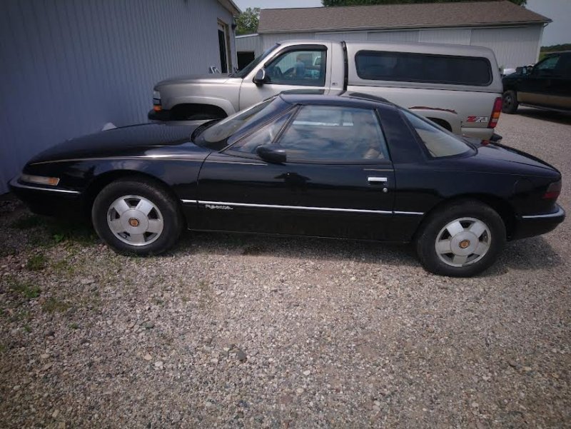

fun car guy Posted July 31, 2021 Topic Author Share Posted July 31, 2021 Okay, I realize I've wavered back and fourth on this and I know you guys are likely tired of hearing about it but I swear this car has a hold on me! After my mechanic estimated $3,500 to $4,000 for him to do the work and regretfully deciding to sell I posted on Facebook Marketplace for $1,500.00 and was buried with interest that afternoon and evening. Some were just curious, some had questions, and some even offered to take it sight unseen but most wanted to come and see it. The first guy showed up, said he already has two Reattas, red and white, but was definitely interested in mine, even said he wanted it after driving it. However, seeing him drive my car down our long driveway and turning on to our access road I had pangs of regret and turned him down. I decided this is my car to slowly repair as I have time and enjoy so I jumped in, started it and drove it on the access road, amazed at how much better it ran and stopped. My mechanic had rebuilt the master cylinder and, although not totally fixed, the brakes are much better making me think I should get myself a better hoist, four jack stands and get busy attempting to finish bleeding the lines and replacing any calipers as needed. Then, take the car into town, fill the tank adding a bottle of injector cleaner. The engine is also running better after the two clogged injectors were cleaned by the mechanic as it turned out to be the reason for the rough running. Of course, I'll repair or replace the tank and lines eventually but at least I'll be able to drive the thing on short distances this summer. Also, a bottle of stop leak took care of the slowly leaking power steering so I'm feeling very positive about this. Thanks for reading and your encouragement, guys! Link to comment Share on other sites More sharing options...
Ronnie Posted July 31, 2021 Share Posted July 31, 2021 That is a really nice looking Reatta. You were wise to keep it instead of sell it at the price you were asking. 2 Link to comment Share on other sites More sharing options...
fun car guy Posted August 1, 2021 Topic Author Share Posted August 1, 2021 Thanks, Ronnie, 2 seater and Ron Walker. Yes, in spite of it's problems, I think I'll be able to make it road worthy again, it's just going to take work, a few more dollars for parts and I'll gain knowledge at the same time. I bought this car knowing it needed repairs and that the mileage was on the high side but it was the best example I could afford and I was eager to learn about it and make it mine. I love everything about the Reatta because there are so many advantages. Being 6'3", I could never fit into a Miata or MG. Besides, they're underpowered and parts are expensive and a Vette is such a cliche. I've always wanted a 2 seater, just for myself and I'm sure you'll agree the Reatta is the perfect choice. Since it's black, once I get it on the road, I'll name it Raven and my vanity plate will read NVRMORE.😏 2 Link to comment Share on other sites More sharing options...
