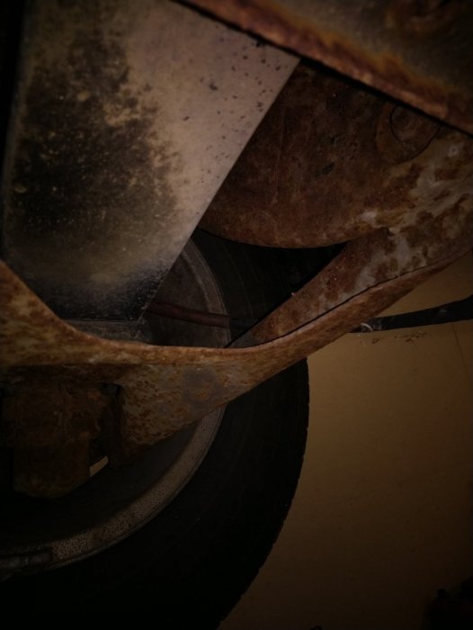

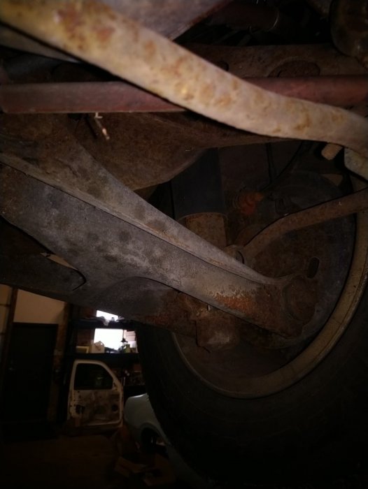

fun car guy Posted June 18, 2021 Topic Author Share Posted June 18, 2021 The car is currently at my mechanic's so I can't check that out but I've asked him to call when he has it up on the hoist so I'll be able to really look things over, check for and rust and take photos to share with you all. My impression, from what I've been able to see is car with very little rust in spite of having been in Michigan since new. It was thoroughly undercoated and I'm hoping my impressions are correct. I've asked them to diagnose the shaking, weak brakes and the power steering leak as well as a thorough safety inspection. I know some of you with more experience and maybe a hoist of your own (or a friends) will accuse me of coping out but even though I can do many things on a car, changing a steering rack without a hoist and figuring out the Teves braking system are beyond me. I just might be able to drive it this summer after all! Link to comment Share on other sites More sharing options...

fun car guy Posted July 7, 2021 Topic Author Share Posted July 7, 2021 Finally heard from my mechanic and he gave me the bad news I expected. only two of the brake calipers are working but he may be able to free them (new rotors and pads of course but I can do that myself), both the fuel and brake lines all badly corroded and need replacement (is stainless available?), the #3 injector is either not spraying or is stuck open, the steering rack is leaking and the rubber on all six engine mounts are shot though the cradle is fine! He's estimating as much as four grand for everything - then, I need new tires of course. So right now I'm thinking the brakes are the priority, it has to be safe regardless, also the bad injector should be replaced. He also showed me the transmission pan is seeping so he wants to open it, drain the old fluid, replace the filter and seal it back up. I've told him to look into the needed work on the brakes first and to call with his estimate, then go from there. The car has 160,000 miles and I paid $1,600 but is almost entirely rust free, the interior is in great shape, everything works except the A/C and the frame is perfectly straight and sound so I'm going to make the car safe first, that way I can at least drive it around for a season or two and then decide if i want the steering rack and engine mounts replaced or take my lumps, sell it at a loss and move on. He tells me he has to lower the engine carriage to access the rack which makes it more expensive than usual but it's not a safety issue so I can simply keep filling the system since I'm not driving it a lot for now and keep a pan under it when in the garage. So, what say ye? I really like this thing even though it needs a lot of work. If I go whole hog I'll have almost 6 grand into it when there's another, a '90 with only 86,000 miles offered for $5,500! Thanks for reading. Link to comment Share on other sites More sharing options...

fun car guy Posted July 7, 2021 Topic Author Share Posted July 7, 2021 A good suggestion about replacing the lines toward the rear but he's telling me they're all so old and rusted that he thinks they will simply begin breaking when he gets into them so, in for a penny, in for a pound there and for safety's sake, I would prefer he replaced them entirely. He didn't think stainless would be available and suggested coated steel instead. Obviously, he's worried about being responsible should the brakes fail. As to the steering rack, I don't know if the leak is from the rack it's self or from one of the hoses - a good question to ask him. As far as the injectors are concerned, he said he would switch #3 for a neighbor and see if #3 works or not. If not, that's an easy and inexpensive fix. They were all replaced by a previous owner 20,000 miles ago. I wouldn't mess with the worn engine mounting bushings unless and until it's necessary to replace the rack. Thanks for your input, Dave! Link to comment Share on other sites More sharing options...
Ronnie Posted July 7, 2021 Share Posted July 7, 2021 1 hour ago, fun car guy said: I wouldn't mess with the worn engine mounting bushings unless and until it's necessary to replace the rack. If the mounts are rusted out really bad the rack will be the least of your worries. Those mounts could be a time bomb that could get you killed. I post this photo pretty often to remind people what can happen. This photo a photo of the mount on my car that shows what a good one should look like. As you can see, in the South we don't have to deal with rust. Link to comment Share on other sites More sharing options...
2seater Posted July 7, 2021 Share Posted July 7, 2021 None of the stuff mentioned above is a show stopper, but it is important to zero in on the items that are defective. Motor mounts and cradle mounts are different animals, with the cradle mounts being very important as pointed out above. Certainly your choice on how much to replace and what material for the brake and fuel lines. I only pointed out the areas that typically rust and from the three I have done, the lines run inside and outside the unibody frame, with a transition from inside to outside under the driver and the forward portion is almost always in good shape. I stagger cut the lines so the seams on the various tubes aren't across from each other. Simple matter to switch injectors or the electrical connector just to see if it is an electrical or a mechanical failure. A noid light on the suspect injector would tell the tale too. We had three power steering leaks on one of my sons cars, the pressure line to the rack, inexpensive and available on Rock Auto, the cooler ahead of the radiator, which got a small two tube aftermarket cooler substitute and the return hose that fed the cooler from the steering rack. Cut and splice in transmission hose. Good luck🙂 Link to comment Share on other sites More sharing options...
