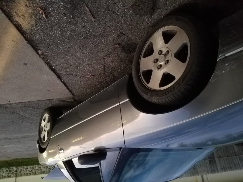

Brock Posted November 9, 2021 Share Posted November 9, 2021 Well... Sharpen your pitchforks and light your torches! Along with a much (50k over) needed tune up and a new LandRover brake accumulator I readied my Reatta for a wrap this last week. I got rid of the badge on the hood and the side molding is gone. I also had the windows tinted. Interior work is on the docket next Edit: I have no Idea why the pic is loading upside down... 1 Link to comment Share on other sites More sharing options...

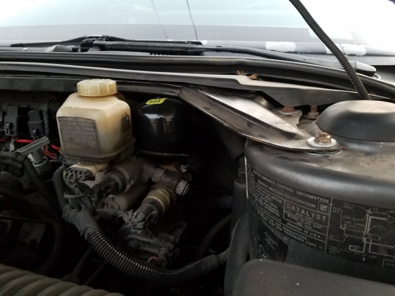

Ronnie Posted November 9, 2021 Share Posted November 9, 2021 You won't get much flack for mods you make to your car. Members of this forum do it all the time. I fixed your photo. It looks like the side molding is still on and has just been painted. What was the part number of the Landrover accumulator you used. That might help someone else who needs one in the future. 1 Link to comment Share on other sites More sharing options...
2seater Posted November 9, 2021 Share Posted November 9, 2021 Yeah, no flack from me either. My windows were tinted back in the 90's and really needs to be replaced. Stock wheels were ditched about that time too, but most of my modifications have been under the hood. I have never looked, but aren't there holes in the metal where some of the side molding mounts? It looks nice and clean but if I did that the car would look like a golf ball in a short time 😎 Link to comment Share on other sites More sharing options...
Brock Posted November 9, 2021 Share Posted November 9, 2021 Thank you Ronnie and 2seater. I am proud of my work but I didnt know if folks around here had a purity thing going on so I tried to head that off with humor... seems I missed a bit... my bad. Side molding is off the door, I promise. The body line is part of the door panel. There were little studs welded to the door that the molding clips on to. Had to grind, fill, prime, sand, prime, sand, prime, sand.... then paint. there were holes in the fender and at the leading and trailing edge of the doors. Used panelbond to adhere a plug to the back and filled them followed by the same regiment of sanding and priming then, of course, painting. oh, and 2seater.... this wasnt my first foray into body work but I wouldnt say that I am really any good at it. It took waaaay longer than it should to remove the golfball look after the grinding! Brake accumulator is from a company called WABCO. P/N STC2784. Originally fitted to a P38 Range Rover... I dont even know what that is or what year, but I got it on amazon for, i think, $270. I have never had brakes this good. only slight mod required is to shim up the strut tower brace with three or so washers. Link to comment Share on other sites More sharing options...
Ronnie Posted November 9, 2021 Share Posted November 9, 2021 53 minutes ago, Brock said: Brake accumulator is from a company called WABCO. P/N STC2784. Originally fitted to a P38 Range Rover... I dont even know what that is or what year, but I got it on amazon for, i think, $270. I have never had brakes this good. only slight mod required is to shim up the strut tower brace with three or so washers. Thanks! Link to comment Share on other sites More sharing options...
2seater Posted November 10, 2021 Share Posted November 10, 2021 I wanted to test a Wabco accumulator because I believe their gas charge is a little bit higher than the Hydac I have. It is interesting that everywhere I look now it brings up Land Rover along with the attendant price increase for that accumulator. That was not the case less than a year ago as well as about $100 price increase. I didn't mean the removal would look like a golf ball, it is the attendant door dings. It certainly does clean up the lines. Link to comment Share on other sites More sharing options...

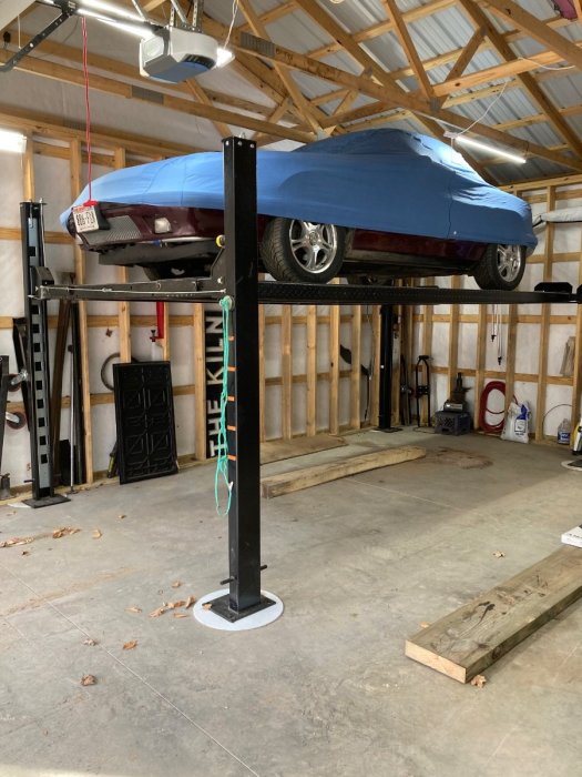

2seater Posted November 24, 2021 Share Posted November 24, 2021 Mine finally went to bed for the winter, in the top bunk. Topped it off, Stabil in the fuel, leather conditioner on seats and dust cover installed. Cool blustery 40* + wind in the 20mph plus range. The plus side was the wind was from the south so temperatures were higher than yesterday and it helped push me to storage. 2 Link to comment Share on other sites More sharing options...
Ronnie Posted November 24, 2021 Share Posted November 24, 2021 Cool. I wish my garage had high ceilings like that so I could install a lift. Link to comment Share on other sites More sharing options...
DAVES89 Posted November 24, 2021 Topic Author Share Posted November 24, 2021 I've been to 2seaters place and he does have a great set up. I walked away impressed and thinking maybe I should remodel my free standing garage. 1 Link to comment Share on other sites More sharing options...
