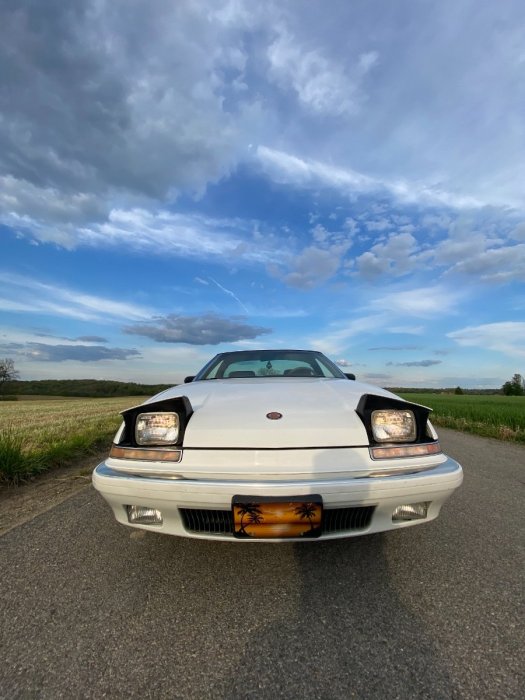

buggzy Posted May 16, 2021 Share Posted May 16, 2021 I washed, clay barred, and waxed the whole car today! After doing so I realized there’s quite a few paint chips and there’s dirt and marks on the front bumper area I can’t get off with the supplies I had. It still looks a lot better than before. Here are a few pics. Link to comment Share on other sites More sharing options...
Ronnie Posted May 16, 2021 Share Posted May 16, 2021 Great looking car. I really like the white. You took some beautiful photos. I didn't know PA was so flat. Link to comment Share on other sites More sharing options...
buggzy Posted May 17, 2021 Share Posted May 17, 2021 21 hours ago, Ronnie said: Great looking car. I really like the white. You took some beautiful photos. I didn't know PA was so flat. Thanks, Ronnie! I love the white too, especially since it doesn’t really show any scratches. Also PA isn’t that flat, it’s just that this was at someone’s farm and it looks flat. 1 Link to comment Share on other sites More sharing options...
