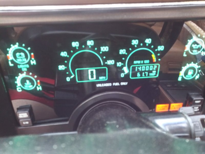

Philbo Posted May 3, 2021 Share Posted May 3, 2021 The reatta hit 140k today 4 Link to comment Share on other sites More sharing options...
