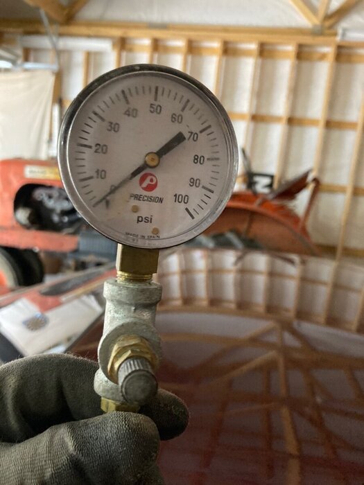

2seater Posted May 8, 2022 Share Posted May 8, 2022 Mine is headed home from storage today but this post is about the Riviera air struts. I have had the air struts for a couple decades but I never really ran air in them. I think the question from some others is what happens to them over time. The photo is my remote fill assembly I made way back when I installed them. I added 50psi and the rear of the car rose from 28.5” to 29.75” measured at the top of the wheel opening. They hold pressure moderately well but they never were perfect in that regard. Long term, they seem to hold up pretty well. Link to comment Share on other sites More sharing options...
