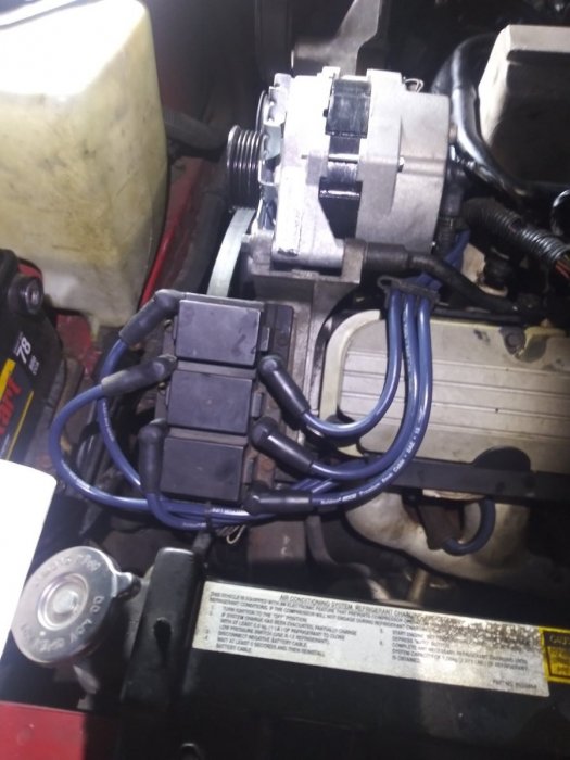

Philbo Posted February 10, 2021 Share Posted February 10, 2021 Inch by inch on my intake manifold/tuneup project. Tonight was installing new spark plug wires. I can't wait to get her running again. 1 Link to comment Share on other sites More sharing options...

Philbo Posted February 13, 2021 Share Posted February 13, 2021 Got it all finished up! Officially without a check engine light since I've owned it. Started with putting a new thermostat in and ended up doing the intake manifold gaskets, fixing the CPS magnet, thorough throttle body cleaning. New air filter, and new spark plugs and wires. She's running better than ever! 2 Link to comment Share on other sites More sharing options...
