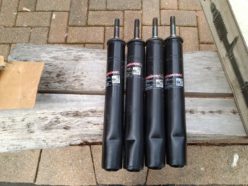

alchemist Posted May 27, 2023 Share Posted May 27, 2023 Strut day... 1 Link to comment Share on other sites More sharing options...
alchemist Posted May 27, 2023 Share Posted May 27, 2023 2 hours ago, alchemist said: Strut day... Half way to keeping four lucky Reattas on the road. 2 Link to comment Share on other sites More sharing options...

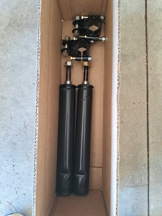

alchemist Posted June 2, 2023 Share Posted June 2, 2023 (edited) On 6/2/2023 at 11:45 AM, Ronnie said: DAVES89 sent me a photo of his rear struts. They almost look like they came from the factory. Looks good! For those who are interested, I have four sets for sale early next week. Two are somewhat spoken for, let me know if you are interested. $275 per set plus $50 shipping. See below for the initial samples of my offering. Edited June 3, 2023 by alchemist 1 Link to comment Share on other sites More sharing options...

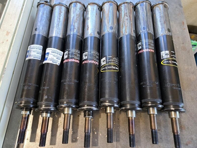

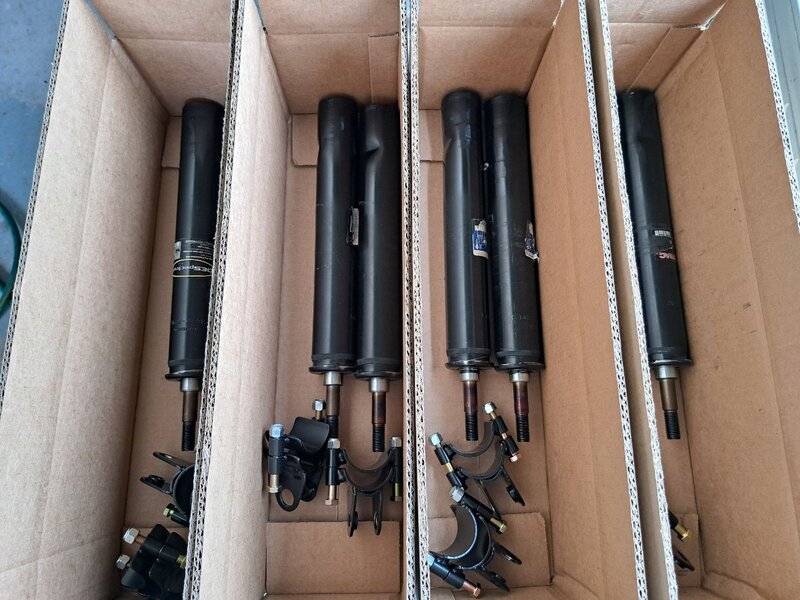

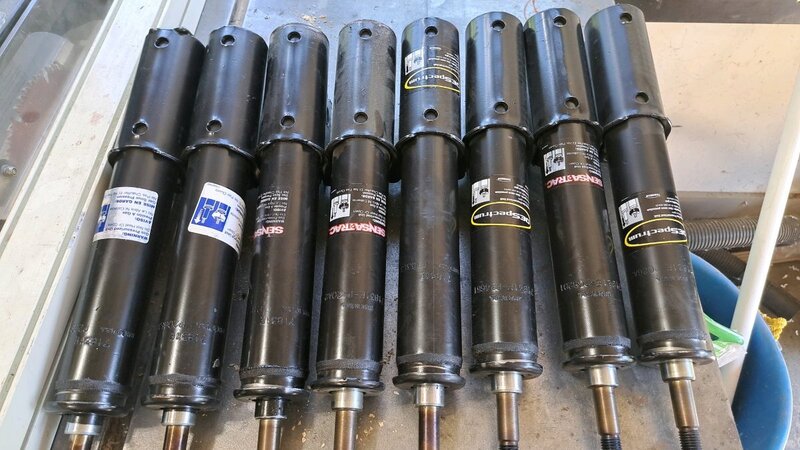

alchemist Posted June 3, 2023 Share Posted June 3, 2023 (edited) Four pairs of converted 1990 Regal struts, ready for shipment. Includes one pair of struts and two sway bar mount adapters. All of these are Monroe Sensa-Trac or OEM Spectrum. which I wholly believe are the same base strut as the part numbers stamped on the bodies are all the same. $325 per pair, includes USPS Priority Shipping. Paypal or Venmo accepted. Can ship out as early as Monday 6/5. Message me to purchase or for additional details or questions. Edited June 4, 2023 by alchemist Link to comment Share on other sites More sharing options...
