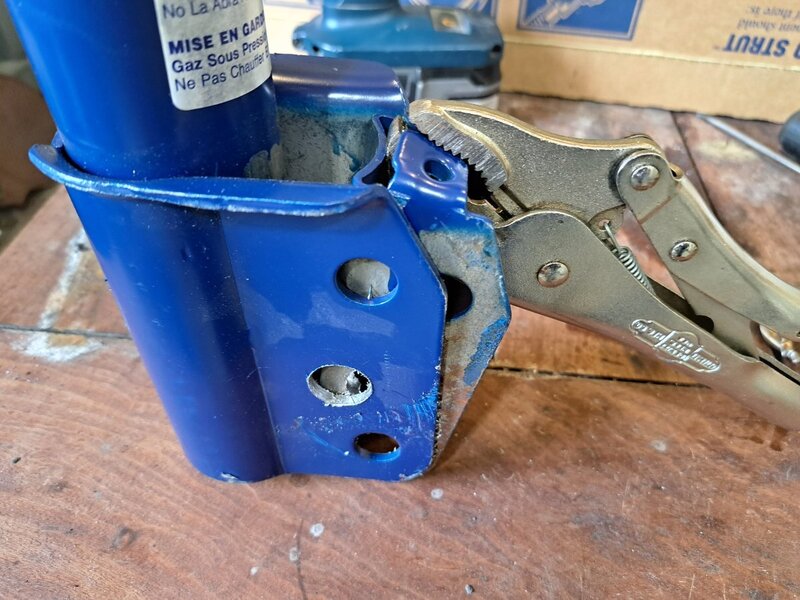

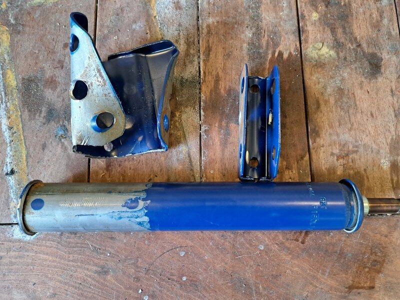

alchemist Posted May 5, 2023 Share Posted May 5, 2023 (edited) Some of you may understand this next statement. I am as happy as Steve Martin when he saw his name in the phone book in the movie 'The Jerk'. Ordered a set of 1990 Regal rear struts, Monroe-Matics as they were on closeout. Took me 15 minutes from when I opened the box until I had a bare strut, ready for dimples and painting. The right tools makes this a very easy job. Bet I could get it down to 10 minutes... Anyone want to buy a set of rear struts? I think I could do this on the side; modify, add dimples, add clamp on sway bar mounts. Sell complete. Edited May 5, 2023 by alchemist 3 Link to comment Share on other sites More sharing options...
Ronnie Posted May 5, 2023 Share Posted May 5, 2023 39 minutes ago, alchemist said: The right tools makes this a very easy job. I feel like a fool asking this but what are "the right tools"? I'm sure it's not just a pair of vice grips. Link to comment Share on other sites More sharing options...

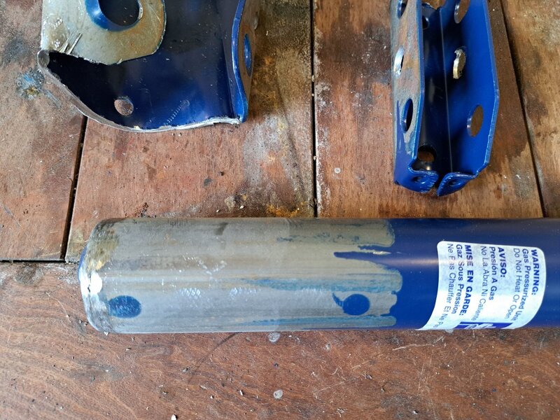

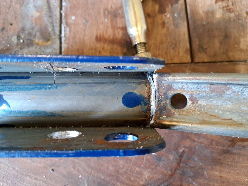

alchemist Posted May 5, 2023 Share Posted May 5, 2023 30 minutes ago, Ronnie said: I feel like a fool asking this but what are "the right tools"? I'm sure it's not just a pair of vice grips. Used an oscilating saw with a carbide metal blade to carefully make a ~0.100" deep cut around the entire base, about 0.100" up from the weld. Used a drill press to bore a 3/4" hole through the spot welds that hold the inner mount (the piece the vice grip was holding onto) to the strut clamp. Vice and bars to peel the brackets away. Snag wheel grinder to clean up the weld on the base. Link to comment Share on other sites More sharing options...

2seater Posted May 5, 2023 Share Posted May 5, 2023 The finished product looks good👍 How tightly is the bracketry squeezing the metal casing? I have been wondering about chucking the rod end in a lathe and then cut the entire base weld off. Precise control of the depth, although most of us don't have a metal lathe, or know how to operate it, but in my imaginary world. Then press the brackets off the tube. Link to comment Share on other sites More sharing options...
alchemist Posted May 5, 2023 Share Posted May 5, 2023 (edited) 31 minutes ago, 2seater said: The finished product looks good👍 How tightly is the bracketry squeezing the metal casing? I have been wondering about chucking the rod end in a lathe and then cut the entire base weld off. Precise control of the depth, although most of us don't have a metal lathe, or know how to operate it, but in my imaginary world. Then press the brackets off the tube. If one could cleanly machine away the weld and match the OD of the tube, it would not take much to get the brackets to slide off. If you look at where the main brackets were, you can see where the paint ran between it and the tube. Edited May 5, 2023 by alchemist Link to comment Share on other sites More sharing options...
