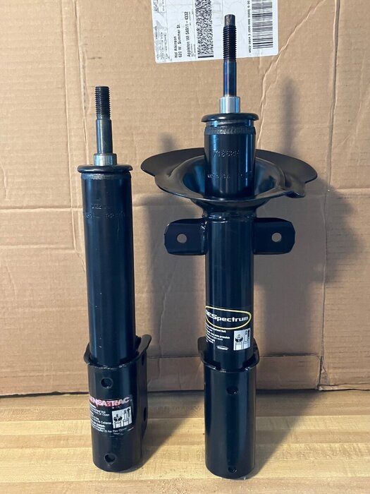

2seater Posted May 1, 2023 Share Posted May 1, 2023 I have purchased parts for the three different forms of strut substitute and the two rear Regal struts are pretty similar to the Reatta in size and function. The brackets welded on are what make them model specific for the most part. What we really need is just the plain strut barrel without the attachments. The strut for the 2000 year Regal appears to be the same barrel diameter as the Reatta but it has a spring perch as well as the lower bracket. I will compare them to the latest proposed substitute, the aforementioned 1990 model, but one thing is for sure, the rod is the smaller diameter like an earlier attempted substitute and it is definitely a strut in function per the suspension diagram. We really need multiple possibilities going forward, including the modification for a strut cartridge. Link to comment Share on other sites More sharing options...

2seater Posted May 2, 2023 Share Posted May 2, 2023 An addendum to the previous post: The 2000 and 1990 rear struts for the Regal have the same body diameter as the original Reatta strut. The 1990 struts arrived today and despite the RA offering described as the OE Spectrum, it is a Sensa Trac. That doesn't matter in the fitment but I always regarded the Sensa Track as a little better internally. Aside from the 2000 strut containing a spring perch, the body length is 2" longer at 16.25". It would need to be seated a bit deeper which looks to be physically possible, but it isn't as good a candidate. 1 Link to comment Share on other sites More sharing options...

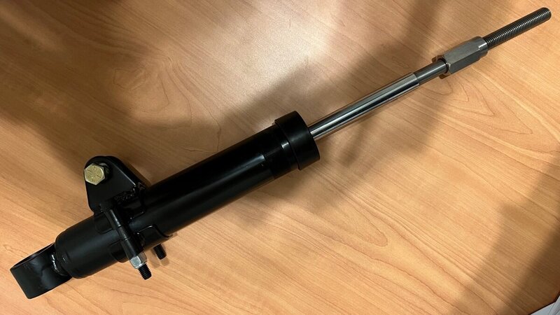

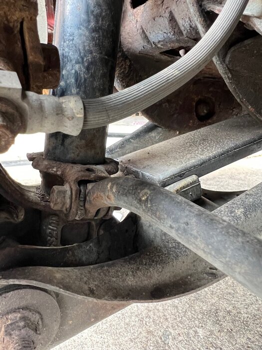

DPS.01 Posted May 3, 2023 Share Posted May 3, 2023 On 5/3/2023 at 8:57 AM, alchemist said: clamp on sway bar adapters Expand Lots of good ideas… each with their own unique limitations / issues for implementation. The clamp on bracket for the sway bar moves the mounting point up on the strut because of the way the bracket was made vs. the “drop connection” point on the OEM unit. The sway bar can be connected, but it needs to be rotated upwards to do so. I am presently running the Allante Cardone Solution on my 1989 originally proposed by @ErnieR earlier in this thread. Allante Cardone solution w/clamp: OEM: Clamp Bracket: Installed (Clamp): Installed (OEM): 1 Link to comment Share on other sites More sharing options...

alchemist Posted May 4, 2023 Share Posted May 4, 2023 On 5/3/2023 at 1:05 PM, DPS.01 said: The clamp on bracket for the sway bar moves the mounting point up on the strut because of the way the bracket was made vs. the “drop connection” point on the OEM unit. Expand How much does the sway bar attachment point move up? Doesn't appear to be more than an inch? Link to comment Share on other sites More sharing options...
