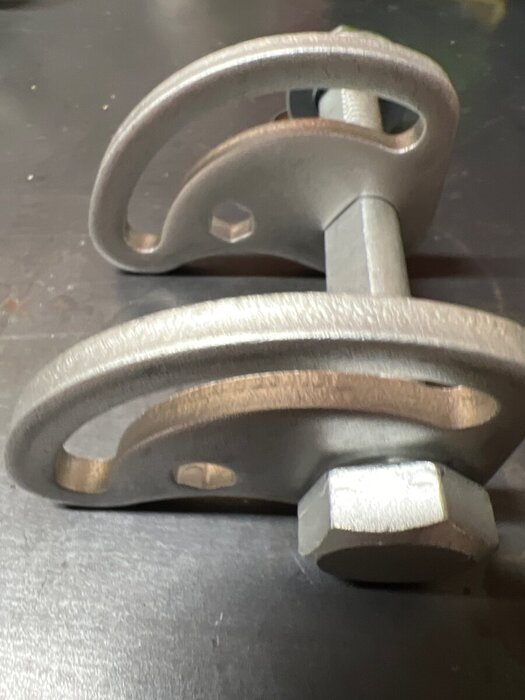

DPS.01 Posted November 20, 2022 Share Posted November 20, 2022 (edited) 53 minutes ago, Padgett said: And the throughbolt below the sway bar ? Not yet… It may not be necessary, but I like the idea of “belts & suspenders”…. Still working on the final plan for that…. @ this point, I am leaning towards a cam alignment bolt or something similar… Edited November 20, 2022 by DPS.01 Link to comment Share on other sites More sharing options...
Padgett Posted November 20, 2022 Share Posted November 20, 2022 Then I am confused. What is holding the shock in place at the bottom in the control arm ? Another bracket ? Link to comment Share on other sites More sharing options...
DPS.01 Posted November 20, 2022 Share Posted November 20, 2022 (edited) No sir. Not another bracket. The lower strut body is still inserted into the knuckle, and the pinch bolt is still used to tighten the knuckle against the strut body. The pinch bolt fits in the are where the lower mount is welded to the body. Pinch Bolt Locations; Allante (L), OEM (R). Strut inserted into knuckle. Due to the 1993 Allante design, the clamping area is ~ 1/2 of the Reatta OEM clamping area. This is why I am considering the bottom bolt to prevent upward movement of the strut out of the knuckle. This is the lower portion of the Allante strut extending below the bottom of the knuckle. The bushing has been removed, the lower mount flattened and filed so that it was 54 mm or less to fit into the knuckle opening. The idea is that the cam bolt will be inserted thru the opening and wedged under the knuckle housing. The sway bar connection point had to be relocated higher on the strut with the clamp, as it does not drop downwards lower on the knuckle. Edited November 20, 2022 by DPS.01 1 Link to comment Share on other sites More sharing options...

ErnieR Posted November 21, 2022 Share Posted November 21, 2022 5 hours ago, DPS.01 said: The Allante would not need the extra clamp. In this application, it is only used as an attachment point for the sway bar. I will put together a parts list and post once the installation is finalized. Yes, the upper portion of the piston is extended using an 18-8 stainless steel coupler, and 12.9 grade threaded rod, ~100mm long. Since my Allante doesn't have a sway bar my plan for the clamp was added reinforcement to keep the shock from moving in the control arm, And, as additional protection against movement I was going to fab two pieces of metal attached to the clamp pinch bolt and extended down to the shocks lower mount. Picture two pieces of metal attached to each end of the pinch bolt with two more holes for a bolt going through the lower shock mount/bushing. 1 Link to comment Share on other sites More sharing options...
ErnieR Posted November 21, 2022 Share Posted November 21, 2022 On 11/19/2022 at 5:45 PM, DPS.01 said: Just finished up on my 1993 Allante strut retrofit for the Reatta w/ sway bar attachment clamp. My 11 year old daughter and I took it on its maiden voyage… no squeaking / rattling, or other odd sounds. Very stiff ride, but I actually like it. Overall, I am extremely pleased with the results so far (10 miles)… the new rear struts did make it obvious that the front struts are overdue for replacement. Photos taken with car on the ground; after ~10 mile run in… I'm glad the installation is a success. I managed a Buick store from 1988 to 1996. Unless you opted for the f41 suspension options the standard ride was always a little soft and somewhat bouncy on most of the cars. I have a 79 Eldorado that I put manually adjustable air shocks on the rear. I run 45 lbs in them to stiffen up the ride. Cornering improved as did highway stability at higher speeds. Not sure what tire pressure you run but some experimenting with that could change the ride characteristics some. Thanks for taking this to the end. 1 1 Link to comment Share on other sites More sharing options...
DPS.01 Posted November 21, 2022 Share Posted November 21, 2022 30 minutes ago, ErnieR said: as additional protection against movement I was going to fab two pieces of metal attached to the clamp pinch bolt This is what I want to try as extra protection against movement of the strut in the knuckle. Eccentric’s would be placed on either side of the lower strut mount and wedged under the knuckle with the bolt going thru the opening that extends thru the bottom of the knuckle. Plan is to try it out this week. I figure it is worth a shot since I have the bolts for my 2003 Tahoe. 1 Link to comment Share on other sites More sharing options...
ErnieR Posted November 21, 2022 Share Posted November 21, 2022 Just now, DPS.01 said: This is what I want to try as extra protection against movement of the strut in the knuckle. Eccentric’s would be placed on either side of the lower strut mount and wedged under the knuckle with the bolt going thru the opening that extends thru the bottom of the knuckle. Plan is to try it out this week. I figure it is worth a shot since I have the bolts for my 2003 Tahoe. When I read your posts yesterday I started looking at Cam Bolts. I didn't think of that at all. I think it's a cleaner and simpler solution. BTW, I could use those resistor bypass wires that came with the Cardones if you want to part with them. 1 Link to comment Share on other sites More sharing options...
