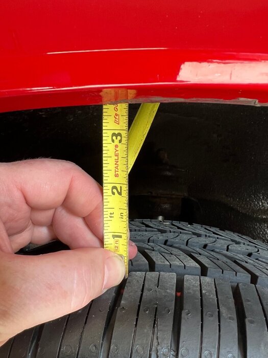

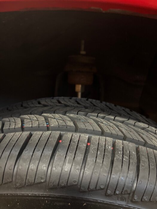

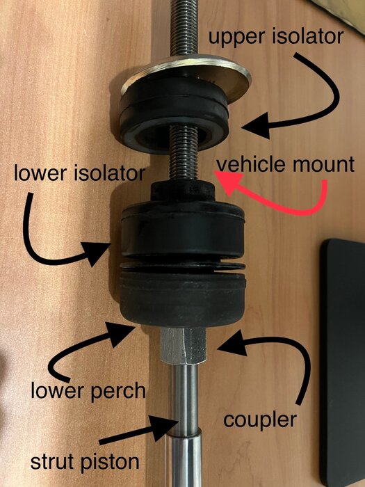

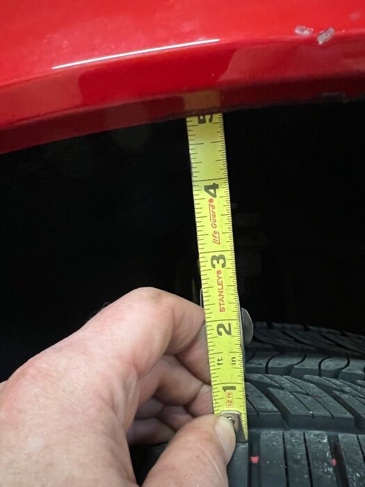

DPS.01 Posted October 29, 2022 Share Posted October 29, 2022 (edited) Update: 10.29.2022 Installed 1993 Allante Cardone shock on the LR of a 1989 Reatta. Did not connect the sway bar; waiting for clamps. Ride Height Before: Ride Height After: The OEM removed strut had zero rebound. The vehicle was riding using the spring only, so initial ride height may be lower than normal. I have not had a chance to complete the passenger side or road test yet. Measurements taken after installation from top of shock body to bottom of coupler used to extend the upper threaded portion of the piston: Full Extension: 6.5” Ride Height: 4.25” Full Compression: 1.75” This means that there is 2.25” of upward travel before the shock tops out and 2.50” of downward travel befor the shock bottoms out. Additional work to do, but this looks promising. Before installed; mock-up: Installed: On the ground: Edited October 29, 2022 by DPS.01 Link to comment Share on other sites More sharing options...
DPS.01 Posted October 29, 2022 Share Posted October 29, 2022 Now when the rear of the car is bounced, there is little to no rebound effect… now that’s a win. Link to comment Share on other sites More sharing options...
Ronnie Posted October 29, 2022 Share Posted October 29, 2022 The fact that you were able to mount them up is really good. That clearance looks like a lot to me. I wouldn't think the gas in the struts would hold the rear of the car up that much with stock struts but maybe it does. I measured the distance from the tire to the lip on the finder like you did and I only got about 2-1/4". But, my car has 225/60-16 tires on it so that might not be a good comparison. Do you have the stock tires and wheels on your Reatta? 1 Link to comment Share on other sites More sharing options...

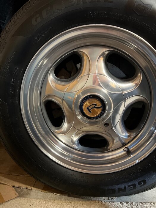

DPS.01 Posted October 29, 2022 Share Posted October 29, 2022 No on both accounts. Wheels were a chained to a tree side of the road special. Tires are 225/60-15 Link to comment Share on other sites More sharing options...

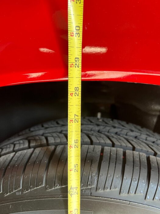

DPS.01 Posted October 29, 2022 Share Posted October 29, 2022 (edited) From ground to fender lip. on my 1984 Skyhawk, the gas shocks on the rear raised it ~1.5” or so when compared to hydraulic OEM units. I don’t think the rear of the Reatta is that heavy with sprung weight, but that’s more of a guess. Gas tank is pretty much empty as well in my photos. Edited October 29, 2022 by DPS.01 Link to comment Share on other sites More sharing options...
Ronnie Posted October 30, 2022 Share Posted October 30, 2022 Mine measures 28-1/4" from the floor to the lip of the fender, almost what yours does. My trunk is full. Two toolboxes, suitcase, chairs and the tank is almost full. So the weight might make quite a bit of difference. A little difference in measurements doesn't matter as long as the struts work well when you get both of them on. 1 Link to comment Share on other sites More sharing options...

ErnieR Posted October 30, 2022 Share Posted October 30, 2022 (edited) Nice work. Looks Good! I've noticed that on every shock or strut installation I've done when I first lower the car it always seems to sit a little higher, but settles after a test drive. Also, the weak side may be a little lower causing the side you measured to be a little higher. Meaningless observations if the ride turns out OK then we have proof of concept. Edited October 30, 2022 by ErnieR 1 1 Link to comment Share on other sites More sharing options...
