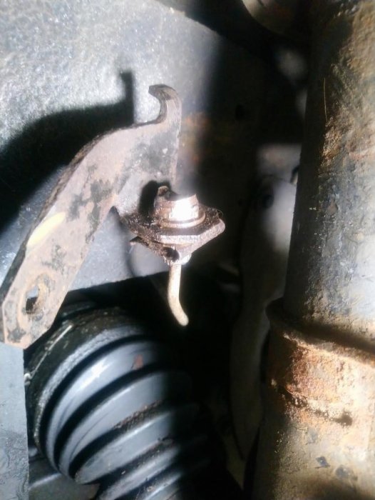

Here's what I'm dealing with.  You can clearly see how rounded off it is by my attempts to break it free using first, open end, then flare and finally vice grip pliers to no avail.  As soon as I took the wheel off I could see that this caliper wasn't working because of the lack of bright metal on the rotor and knew the flex hose was bad.  My plan is to use my Dremel tool to cut the feed tubing just below the connection, get a new fitting bringing it in to the parts dealer to match tubing diameter, slide it on, flare the tube (something new to me) and hook things up.  Once I get this sorted it's back to the remaining rear that I couldn't bleed but it looks like it's working so I may not bother with it.  As always, thanks for your help.
Before you cut the line give it one more try. Drive a small screwdriver with a thin blade between the spring clip and the bracket in the area highlighted in blue in your photo below to push the clip down. Then stick a small Philips screwdriver (or other small steel rod) into the hole (pointed to with the red arrow) and rip the clip off the hose. There isn't anything to that clip so should come right off. (see second photo)
That might free the bracket from the hose and allow it to slide down around the tubing out of the way so you can get a better grip on the fittings.

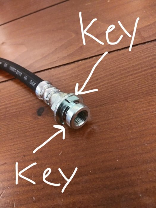

I don't remember exactly but it is very likely the hose end on top of the mounting is keyed or otherwise kept from rotating due to the shape of the hose end. In other words, the hose won't rotate when installed and is likely that way due to the rotating nature of the front brake hose. The only thing that will rotate is the tube fitting. Looking at that setup, there may be enough material to do the flare on the remaining tube but my guess is a splice may need to be made somewhere else.
I bet it is keyed. That's how the brake lines on my '95 GMC suburban are (which I am replacing right now).  Knowing GM it is the same or very similar part (see picture)

It probably is keyed. My thinking is if you take the clip off the bottom that holds the hose down in the bracket you could slide the bracket out of the way. Once that is done I think you could put a small pipe wrench around the remaining metal part of the hose and a small pipe wrench on the fitting for the tubing that screws into it and break the fittings loose. Yes I know that is a crude way to do it but sometimes brute force is what is needed to get the job done. A pipe wrench can put more clamping force and more bite on the fittings than any channel lock or vice grip pliers. The harder you pull on the handle of a pipe wrench the tighter it squeezes.

The pipe wrench doesn't have to be large, which is the image that springs to mind. Something 8"-10" for the size we are looking at. put a short length of pipe over the handle for more leverage. I know I have crushed pipes when trying to remove one that's rusted/stuck due to the clamping force available when twisting. It would need to be pulled free of the bracket as Ronnie said to be able to get something around it.
Thanks Ronnie, I'll give it another try but if it doesn't work I'll just cut the line and grind the #@&% thing off and be done with it!  I hope it will at least free the clip so I can reuse it.
New clips are available at Advance and most of the other parts stores. Don't worry about tearing it up to get it off. Good luck!
