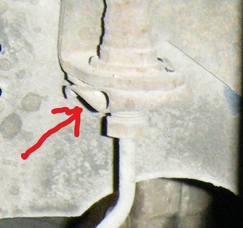

This is another place where tubing wrenches are your friend. If you haven't done so remove the spring clip on the hose so you can move it around in the bracket to get to the fittings better.
Thanks Ronnie,
I didn't even know that was removable, thought it part of the back plate!  I think that, and cutting off the old hose so I can get a socket on the fitting should help a lot.  The clip is pretty rusty of course but I think a few taps with a hammer will free it so I can pull it out but meanwhile, I'll keep soaking it.

Freed the clip but it won't come out, just rotates.  No problem as the fitting is obviously frozen so it's off to NAPA for a tube flaring kit and new tube fitting.  Also to exchange one of the new hoses as they gave me two left handed ones.  ON THE PLUS SIDE, the other front caliper appears to work but I have to decide if I should change it anyway, I think I'll see of the same fitting on the left will be more cooperate.  If so, I might as well replace the caliper and hose.
