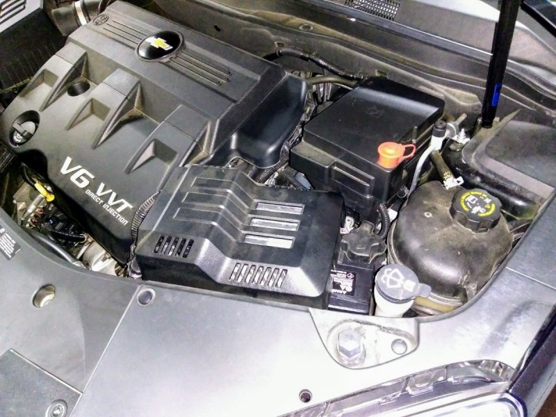

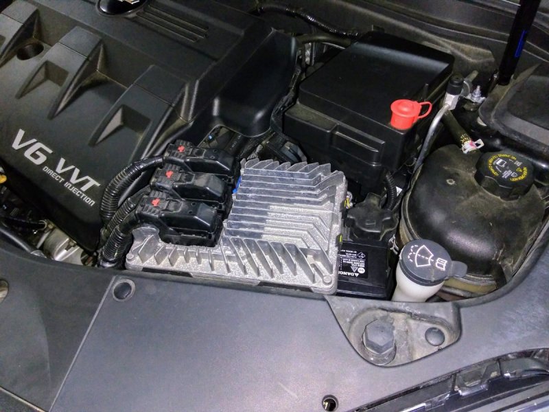

Ronnie Posted October 25, 2021 Topic Author Share Posted October 25, 2021 The odd thing about the battery on the Equinox is the computer is mounted on top of it and must be removed just to get the battery out. Once the computer is removed and the bracket that serves as a mount for the computer and a hold-down for the battery, the battery must be pulled out of a box where it is so close that it is extremely hard to get a hold on it. Of all the batteries in the world that GM could have used, the Delco battery that was in it didn't have a handle to pull it out with. I was happy to see the new battery had a handle built into the top of it. Made it much easier letting it down in the box for the battery. I like the Equinox but it wasn't made to work on. Link to comment Share on other sites More sharing options...

Ronnie Posted October 25, 2021 Topic Author Share Posted October 25, 2021 I think it is called a PCM on the Equinox but I'm not sure. A black plastic cover has to be removed and the silver box is underneath. You can just see the negative post of the battery peaking out on the right side of the computer and the hot post of the battery is under the computer. If you want to jump start the battery you would have to use the remotely mounted stud for the hot post that is under the red cover behind the PCM. I did connect a 12 volt battery to the cables to keep the computers awake while I swapped the batteries so I didn't have to reenter the all the settings. 2 Link to comment Share on other sites More sharing options...
