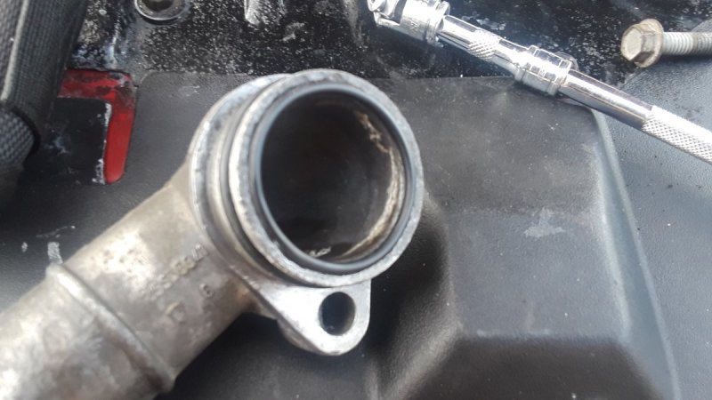

89RedCoupe Posted December 31, 2019 Topic Author Share Posted December 31, 2019 Another day another dollar spent.... I discovered that NAPA auto parts had cooling fan motors in stock for $39 each, so rounded one up for installation today. I also had the thermostat seal coming my way in the mail. The mail usually comes around noon, when I was working on the car, but it was past 4 before he arrived today. In the interim I wondered if I had something else on hand that would work. I had ordered some 34mm o-rings for my Honda Reflex scooter intake manifold and they were the perfect size to fit down inside the little recess of the thermostat housing. I used Super Glue to secure it in place, then put it back together along with the new fan motor. I warmed up the engine in the driveway. I tried the AC settings and both pusher and puller fans came on without the necessity of a finger push. I let the car run for another 15 minutes as I watched the gauge panel readouts climb up past 200 degrees. I was afraid that something would blow up if it got much hotter, but when it hit 210 degrees, suddenly the temperature started dropping back down (AC off) and I checked the puller fan which was running on its own just fine. I have left the 180 degree thermostat in place so far. A nice 20 minute drive through town and on the freeway showed the coolant temperatures staying right around the 180 degree mark, plus or minus 10 degrees depending on whether it was on the highway or in traffic. The temperatures are in the 60s today, so that helps keep things cool on the highway. It was all wrapped up when the thermostat seal finally arrived. It was smaller than I expected and I can see how it nestles into the housing without jacking the height up too much more. I will keep it aside and perhaps put the 195 degree thermostat back in to try to improve the gas mileage, which has been hovering around 17 mpg thus far. Tomorrow I will revisit the window stops in the driver door, now that the window is fully functioning again. Thanks to all for the feedback, suggestions and encouragement so far. Link to comment Share on other sites More sharing options...

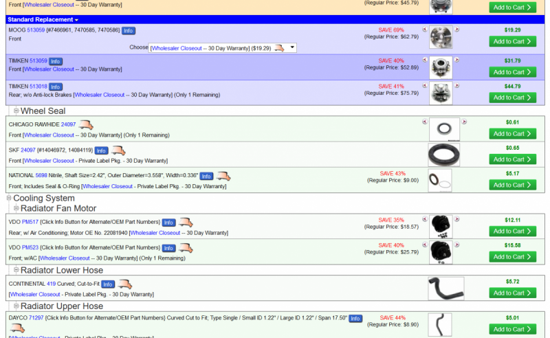

Studebaker Posted December 31, 2019 Share Posted December 31, 2019 Hey 89 Red......I used to buy alot of parts from Advance Auto and other local suppliers until someone mentioned Rock Auto.....and now I always at least go there and check their prices. It seems that usually they are far lower, and that includes the shipping costs. For example, your $39 fan is on sale at Rock for between 12 -15 bucks.....so, you may want to give them a try sometime. Here is a copy of their page showing the fans: Glad to see you got the fan/o-ring issues taken care of. 1 Link to comment Share on other sites More sharing options...
Ronnie Posted December 31, 2019 Share Posted December 31, 2019 12 minutes ago, Studebaker said: someone mentioned Rock Auto.....and now I always at least go there and check their prices. I don't buy a lot from RockAuto but I use them a lot to check part numbers to make sure what parts will fit correctly. They have the most accurate catalog of any of the auto parts stores and the largest selection of brands to choose from. Once I use RockAuto to determine the correct part number I need I go to Amazon to see if they have a better price that includes free shipping. I purchase most of my parts from Amazon. Link to comment Share on other sites More sharing options...
89RedCoupe Posted December 31, 2019 Topic Author Share Posted December 31, 2019 Wow, great prices, especially on close-out items. I imagine that some shipping charges are added to those prices, but it looks like a great time to stock up on some of those parts. Thanks for the tip.. Link to comment Share on other sites More sharing options...
DAVES89 Posted December 31, 2019 Share Posted December 31, 2019 (edited) I go to Rock Auto and look for close outs and then buy them to stock up my parts bin. Things like air/oil filters, wiper blades, spark plugs/wires, O2 sensors, water pumps, tie rods, hub assemblies, serpentine belts, cam sensors/magnets, etc. stuff I would always need. Then if there is something I'm low on or a surprise repair, I go to Advance and "window shop" putting something in the cart. Then I wait for an e mail from them offering 25% on my cart item. Then if I have a coupon for $5.00 I use that as well. If I'm under $25.00 I add a couple of low cost items to get there and the price is pretty close to Rock. I also use E bay and Amazon to compare pricing. We are Prime members so I get stuff fast and free from Amazon. Then of course I sell a few parts from Gibson's my local You Pick yard to offset my parts purchases... Edited December 31, 2019 by DAVES89 1 Link to comment Share on other sites More sharing options...
89RedCoupe Posted December 31, 2019 Topic Author Share Posted December 31, 2019 Great strategies from an obvious Reatta expert. Thank you! 1 Link to comment Share on other sites More sharing options...
Studebaker Posted December 31, 2019 Share Posted December 31, 2019 89 Red.......Yea, it took me awhile to discover how to go straight to all of their discounted parts. When you click on "Reatta", you then click on the Yellow square that says "RSS". This takes you to a new screen, and then you go to the right where it says "Love A Bargain", and then click on the Blue square that says "HTML". Then it takes you to some deeply discounted parts, sometimes about 80% off. Dave89.....Yep, I try to stock up a bit for my various vehicles, especially on those discounted parts. I used to use Advance coupons like you do, but have usually always found Rock to beat them in a big way, but will compare on big ticket items. Ronnie.....I will have to try Amazon more often, but dont have the free shipping as you do.....and that shipping can add up big time. Link to comment Share on other sites More sharing options...
