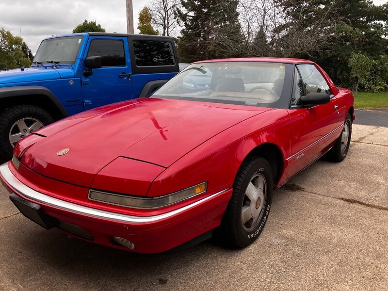

Bradgardens Posted October 17, 2023 Share Posted October 17, 2023 Today I drove mine home for the first time! 2 Link to comment Share on other sites More sharing options...
DAVES89 Posted October 18, 2023 Topic Author Share Posted October 18, 2023 1 hour ago, Bradgardens said: Today I drove mine home for the first time! Good for you! It looks great. How's it drive? No issues I hope. Link to comment Share on other sites More sharing options...
