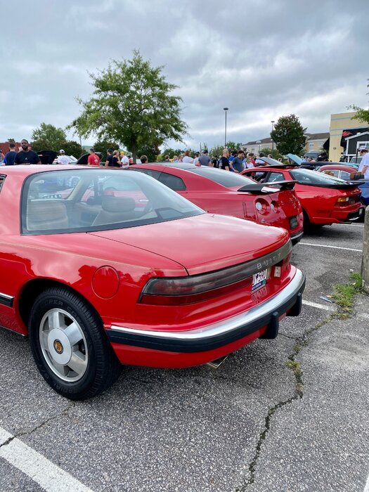

Nailhed66 Posted July 24, 2022 Share Posted July 24, 2022 I recently took my’ 88 to Cars and Coffee Columbia,SC. I like these because they start at 7:30 am and break up around 10. Hot and humid here all summer long, thankfully my AC is working well ! 3 Link to comment Share on other sites More sharing options...
