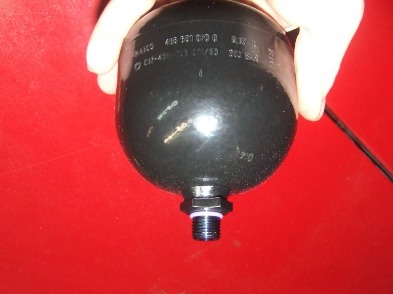

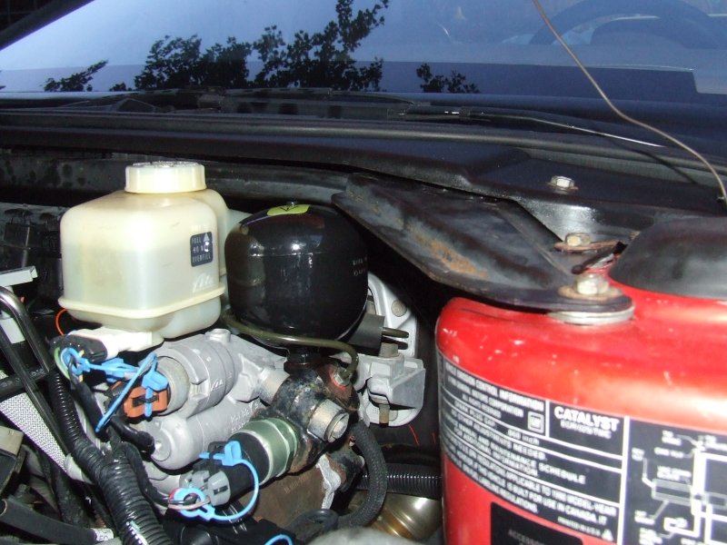

heygibb Posted September 1, 2017 Share Posted September 1, 2017 After failing both ROJ accumulator tests, I installed a new WABCO STC 2784 accumulator in my ’90 coupe. Threading was exact fit. Only mod was to shim up cross brace w/ a couple of large washers at each attachment lug. W/ old accum, I got zero pedal pushes before pump engaged. Now I get 5-6 pedal pushes after system is pressurized. Initial pressurization is ~21 seconds. The fluid level in the reservoir drops 3/8” during pressurization. I purchased from supplier in England on eBay. I received it in 2 days. Cost was $159.99, delivered. I contacted MeritorWABCO to verify warranty. It’s good to go. I've had no problems in 3 weeks of use. Link to comment Share on other sites More sharing options...

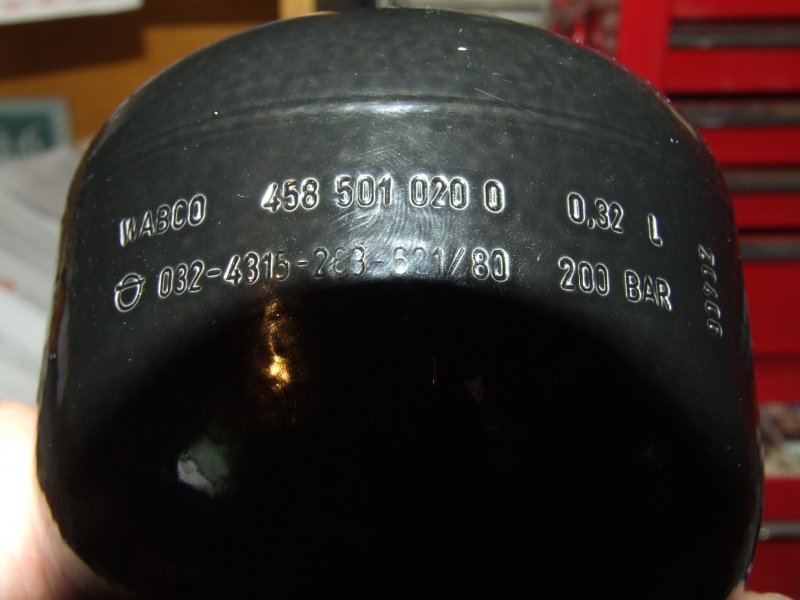

2seater Posted September 5, 2017 Share Posted September 5, 2017 Does the Wabco list what the gas pre-charge is? The rated pressure and fluid capacity are the same as the Hydac, or very close, but the level of charge is of interest. It sounds like it is certainly in the ballpark but I am curious as it has a direct bearing on the reserve capacity. Link to comment Share on other sites More sharing options...
heygibb Posted September 5, 2017 Topic Author Share Posted September 5, 2017 Does 80 BAR sound about right? That number on the ball, ending w/ /80 could be an indicator. The "200 BAR" immediately following it would be the max pressure rating. I have no official specs re this though. Re reserve capacity, are you referring to the need for the pump to keep it pressurized? After starting pump w/ key on, engine off, I consistently get to the 6th pedal push before pump restarts. The info could probably be had here. There is an email link for technical help. This model is STC 2784. http://www.meritorwabco.com/Contact-Information Link to comment Share on other sites More sharing options...

2seater Posted September 5, 2017 Share Posted September 5, 2017 Does 80 BAR sound about right? That number on the ball, ending w/ /80 could be an indicator. The "200 BAR" immediately following it would be the max pressure rating. I have no official specs re this though. Re reserve capacity, are you referring to the need for the pump to keep it pressurized? After starting pump w/ key on, engine off, I consistently get to the 6th pedal push before pump restarts. The info could probably be had here. There is an email link for technical help. This model is STC 2784. http://www.meritorwabco.com/Contact-Information Yes, 80 bar, or 1,176 psi sounds like it could be. That is a fair amount greater than the Hydac sticker pressure of 1000psi, and could be of some benefit. What matters is how much fluid is contained in the ball in the 2000-2600psi range and it sounds like it is working well. I am almost tempted to buy one just to check the capacities compared to others I have tested. The 200 bar does sound right, just shy of 3000psi, about the same as all other compatible accumulators. It is a good find. Link to comment Share on other sites More sharing options...
heygibb Posted September 5, 2017 Topic Author Share Posted September 5, 2017 re your Hydac number. Since it's precharge pressure is lower, that would explain why those using it have fewer pedal pushes after pump is off, no? From what I have read, seems like 3 or so is the mean. I'll keep an eye out for your bench test, if you do one. Your info is appreciated. Link to comment Share on other sites More sharing options...
2seater Posted September 5, 2017 Share Posted September 5, 2017 re your Hydac number. Since it's precharge pressure is lower, that would explain why those using it have fewer pedal pushes after pump is off, no? From what I have read, seems like 3 or so is the mean. I'll keep an eye out for your bench test, if you do one. Your info is appreciated. The number of pumps seems to be somewhat flexible, and since all of the data we have is from different installations, it is difficult to make a hard judgement. I did a series on my own car with a selection of accumulators to better judge the comparative merits of each one and would be the only real way to judge if one is better than the other. A bench test does tell a story but can be duplicated pretty accurately with a pressure gauge on the car. I do think that somewhat higher pre-charge may be of benefit if accurate. Link to comment Share on other sites More sharing options...
