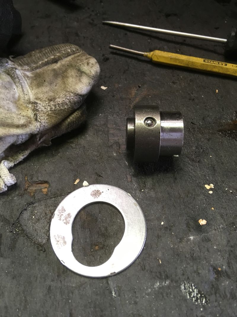

Aztec62 Posted September 10, 2017 Topic Author Share Posted September 10, 2017 Hello, Today I have found a way to dismantle the pump body without damaging anything. Check out the photo: Link to comment Share on other sites More sharing options...

Aztec62 Posted September 11, 2017 Topic Author Share Posted September 11, 2017 Folks, thanks a lot for the suggestions. I think the only reason why the pump worked on the bench and not in the car is that it got contaminated again. It has nothing to do with the master cylinder, it was not even connected to it. The lowest amount of dirt will block this pump. The plungers are so small and light, even contamination you will not be able to see with your eyes will keep them from moving out of the spinning rotor under centrifugal force. For me it is a little wonder this pump can safely operate in a car brake system at all. Link to comment Share on other sites More sharing options...
2seater Posted September 11, 2017 Share Posted September 11, 2017 Folks, thanks a lot for the suggestions. I think the only reason why the pump worked on the bench and not in the car is that it got contaminated again. It has nothing to do with the master cylinder, it was not even connected to it. The lowest amount of dirt will block this pump. The plungers are so small and light, even contamination you will not be able to see with your eyes will keep them from moving out of the spinning rotor under centrifugal force. For me it is a little wonder this pump can safely operate in a car brake system at all. Strange it is so easy to jam the pistons? I have seen some pretty ugly fluid that seems to work fine in the pump. As a matter of fact, the fluid I use in my test setup is just recycled used stuff. I do a basic straining of the fluid and am now working on de-hydrating it in a vacuum chamber, but it is by no means pristine. The pistons may be light but the weight of the fluid above the piston should give it some heft? Sure seems like a fluid feed issue on the reservoir side. Link to comment Share on other sites More sharing options...
