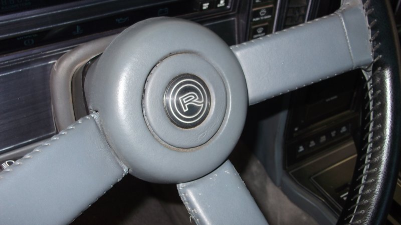

AZ Ron Posted April 15, 2017 Share Posted April 15, 2017 You have one of the earlier ones. Does yours have the dark horn button? Here is a pic of my 88's horn button. Looks to be dark but I have nothing to compare it to. Ronnie - the center of my horn button is black with a silver R. Test 1: 26 pumps for both to come on. Test 2: 21 pumps until the pedal suddenly became very hard. Link to comment Share on other sites More sharing options...
Ronnie Posted April 15, 2017 Topic Author Share Posted April 15, 2017 You have the early '88 model horn button. Here is how the latter '88 & 89 buttons look. I use a photo of one for my avatar. Link to comment Share on other sites More sharing options...
