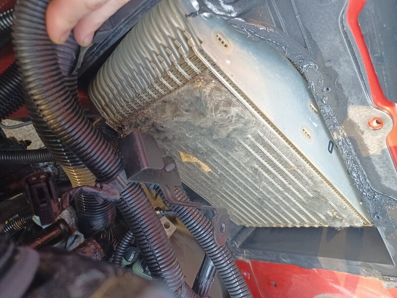

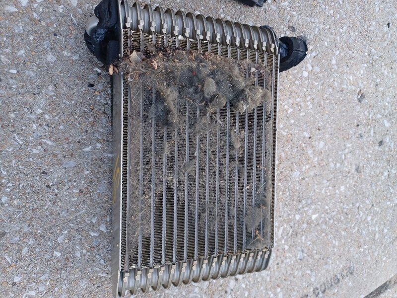

Anthony Posted June 30 Share Posted June 30 I would also suggest removing the blower motor and looking inside with a flashlight and mirror to see if the evaporator is clean. The insulation that they used around the housing disintigrates and gets sucked into the fins. This is what mine looked like: I replaced this whole evaporator as part of a system overhaul, but one could probably just stick a vacuum hose in through the blower motor hole and suck that crap out without disassembling anything 1 Link to comment Share on other sites More sharing options...
2seater Posted June 30 Share Posted June 30 You can also remove the blower control module directly at the top of the heater plenum by itself or in concert with the blower motor. View from the top and insert vacuum from the right. Brake clean spray or other cleaning fluid sprayed on the face of the evaporator will help if there is a sticky film present. 1 Link to comment Share on other sites More sharing options...
DAVES89 Posted June 30 Share Posted June 30 6 minutes ago, 2seater said: You can also remove the blower control module directly at the top of the heater plenum by itself or in concert with the blower motor. View from the top and insert vacuum from the right. Brake clean spray or other cleaning fluid sprayed on the face of the evaporator will help if there is a sticky film present. To add to 2seater I would spray brake cleaner and then follow up with water spray to neutralize. Then compressed air to dry the water and repeat with brake fluid, water, air until clean. Just never liked the idea of solvents around engines. Link to comment Share on other sites More sharing options...

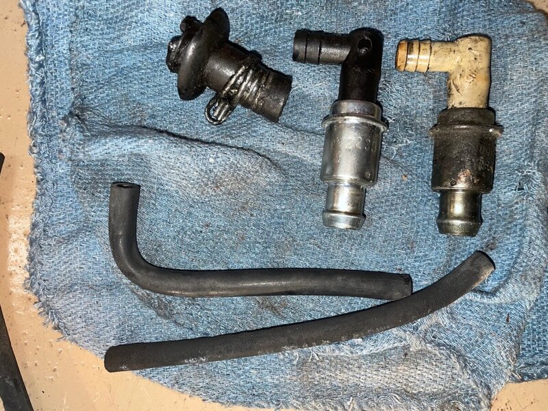

wufibugs Posted June 30 Share Posted June 30 Isn't brake cleaner acetone? As I understand it, the whole point of using it as a paint prep is that it does not leave any residue? Make sure you get both grommets to go with the PCV valve. If you are able to get the valve out without destroying one or both, and they still have some flexibility, you'll have the grommets for the when they do have to be replaced. Link to comment Share on other sites More sharing options...
Anthony Posted July 1 Share Posted July 1 Regarding the PCV grommets, if you change those, be very careful when removing them they tend to break apart if they're old and brittle and fall inside the engine. Don't ask me how I know 😳 Link to comment Share on other sites More sharing options...
radride90 Posted July 2 Topic Author Share Posted July 2 On 6/30/2024 at 4:26 PM, wufibugs said: Isn't brake cleaner acetone? As I understand it, the whole point of using it as a paint prep is that it does not leave any residue? Make sure you get both grommets to go with the PCV valve. If you are able to get the valve out without destroying one or both, and they still have some flexibility, you'll have the grommets for the when they do have to be replaced. On 6/30/2024 at 8:21 PM, Anthony said: Regarding the PCV grommets, if you change those, be very careful when removing them they tend to break apart if they're old and brittle and fall inside the engine. Don't ask me how I know 😳 yea, i went thru that a couple weeks ago, they were pretty bad shape, looked like this— yes i lost a small piece i had to fish out with a wire hook out of plenum, not the case thank God the new one was not easy to install either 1 Link to comment Share on other sites More sharing options...
