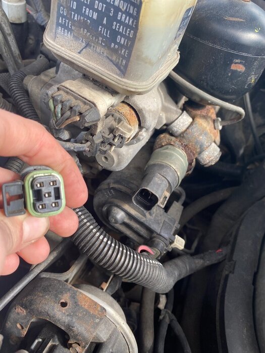

2seater Posted October 15, 2023 Share Posted October 15, 2023 Pull the electrical connector from the pressure switch on the brake pump and check it for fluid contamination. It should be clean and dry. If fluid is leaking through the switch, it must be replaced. 1 Link to comment Share on other sites More sharing options...

89reattaWI Posted October 15, 2023 Topic Author Share Posted October 15, 2023 I’ll drive over to where it’s being stored today and look at the lights. the lights on the dash are the amber abs, service engine soon, and an electrical problem light. i think the red brake light was on but it turned off awhile ago after the accumulator was replaced. While i’m there i’ll pull the connector and check it out thank you guys. Link to comment Share on other sites More sharing options...
89reattaWI Posted October 15, 2023 Topic Author Share Posted October 15, 2023 not sure if this is it but this connector looks really good. Link to comment Share on other sites More sharing options...

Ronnie Posted October 15, 2023 Share Posted October 15, 2023 Have you determined the the brake pump is actually where the noise is coming from? If it's the pump, the noise should have stopped when you unplugged the connector you have in your hand. Link to comment Share on other sites More sharing options...
89reattaWI Posted October 15, 2023 Topic Author Share Posted October 15, 2023 1 hour ago, Ronnie said: when you unplugged the connector i didn’t have the car running so i’ll go check in a minute. and thanks rogold i’ll look into that. Link to comment Share on other sites More sharing options...
Ronnie Posted October 15, 2023 Share Posted October 15, 2023 51 minutes ago, 89reattaWI said: i didn’t have the car running You don't need the engine running. You just need the key turned to the "run" position for the brake pump to run. 1 Link to comment Share on other sites More sharing options...
