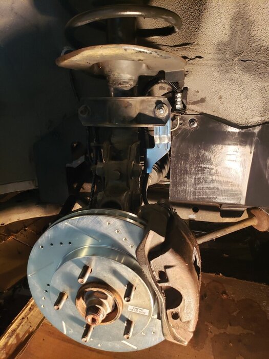

Alchemy333 Posted January 20, 2023 Topic Author Share Posted January 20, 2023 10 hours ago, DAVES89 said: Just now received my Saab right front wheel speed sensors. They are approximately the right length, have the correct connector, have the rubber mounting boots in approximately the right places and have about the same resistance. There should be no reason they don't work. Remember the head is configured a bit different so it looks like an adapter piece will have to be made for the barrel hole and mounting bolt. Looks like an excellent value/replacement for less then $32.00 delivered I got a pair in my cart if need be. Went ahead and removed and inspected both front WSS's. The one popping code was gunked up and the gear was pretty clogged with crud. The coax wire was good where the insulation was falling off from sitting 10yrs, so I went ahead and wrapped it with electrical tape to see how it goes. Added 2 new rotors, new hydraulic lines and Bosch pads... greased the ball joints. Overall, the braking is 80% better. But, still feel a push/movement in the pedal. Its when im sitting still mostly. Applying brakes while moving now feel fine (havent slammed on it or taken over 30mph yet). ABS light still on, but haven't run new codes yet... a bit exhausted. Will pull new codes this weekend. Im looking into hitting the rear brakes now, which need addressing, but the horror stories I read on various threads make me feel a bit timid. Are the rears really as complicated as so many make it out to sound? Link to comment Share on other sites More sharing options...

Ronnie Posted January 21, 2023 Share Posted January 21, 2023 17 hours ago, Alchemy333 said: Applying brakes while moving now feel fine (havent slammed on it or taken over 30mph yet). ABS light still on, but haven't run new codes yet... The way the codes in the EBCM are cleared is by driving the car. I don't remember the minimum speed but maybe 30 mph isn't fast enough. In this case disconnecting the battery won't reset the ABS codes like the other computers. 1 Link to comment Share on other sites More sharing options...
Ronnie Posted January 21, 2023 Share Posted January 21, 2023 After you drive it , if the ABS light is on, check for codes again. 1 Link to comment Share on other sites More sharing options...

Alchemy333 Posted January 22, 2023 Topic Author Share Posted January 22, 2023 I was reading some older threads regarding the ABS light not going out (with no codes), and decided to replace the 2 Echlin AR174 relays. Still no change. Brakes good... still no ABS. Ran the car around the neighborhood a few times, then attempted to run codes again... it does nothing. No blinking at all still. I feel the self check click in the brake pedal when I start it up, so that knocks off a few more potentials. Any chance this is an issue based on not addressing rear brake pads/rotors yet? No rear codes popped up when codes originally pulled. @Ronnie Link to comment Share on other sites More sharing options...
Ronnie Posted January 22, 2023 Share Posted January 22, 2023 1 hour ago, Alchemy333 said: then attempted to run codes again... it does nothing. No blinking at all still. The light should blink even if there are no codes stored. No flashes is an indication the EBCM isn't working. Make sure you are shorting the correct terminals and check the ABS fuse under the dash Brake Pump & ABS Fuse Location. 1 1 Link to comment Share on other sites More sharing options...
