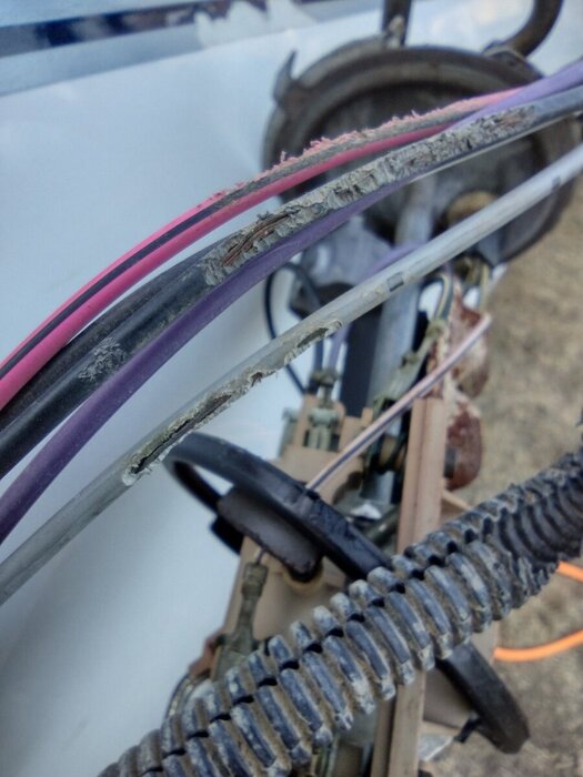

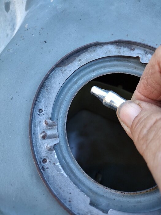

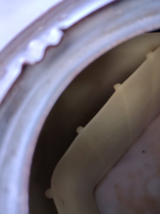

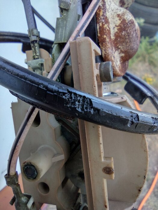

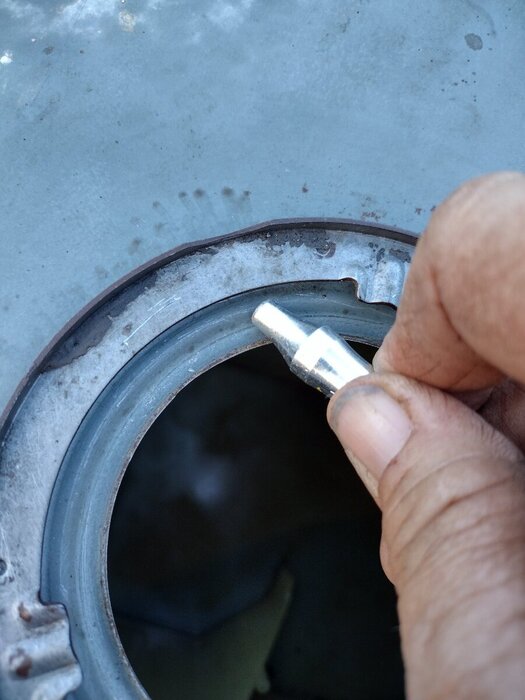

CarrieJT Posted October 8, 2022 Topic Author Share Posted October 8, 2022 Update. Finally got tank out. Rats chewed some wire plastic so I guess taping them is best fix? (Pics to follow). Also, I took pics of the ring after I removed pump. I can blow air right thru it...which explains the dust I saw in the gas I dumped out. Any ideas on what to seal this with? Also took pics of baffle inside tank in case anyone is curious. I see mine is broken somehow... And finally, a pic of the o-ring seal...looks a little rough!! I'll have to order one since it didn't come with my pump. Link to comment Share on other sites More sharing options...

CarrieJT Posted October 15, 2022 Topic Author Share Posted October 15, 2022 (edited) Got new pump in. Carter. I have them in my jeeps. Now, do I need to caulk or something around the ring where it meets the tank? My picture was trying to show I can blow air and debris out thru it. Edited October 15, 2022 by CarrieJT Link to comment Share on other sites More sharing options...

Ronnie Posted October 15, 2022 Share Posted October 15, 2022 1 hour ago, CarrieJT said: Got new pump in. Carter. I have them in my jeeps. Now, do I need to caulk or something around the ring where it meets the tank? My picture was trying to show I can blow air and debris out thru it. Delphi FE0039 pump I used came with the o-rings to seal the assembly to the tank. No caulk or sealer needed. Link to comment Share on other sites More sharing options...

Ronnie Posted October 15, 2022 Share Posted October 15, 2022 Be sure you use the short hose that should have came with your new pump (shown in my last photo. The rusty pulsator shown in your photo should be replaced with the hose. Get the hose clamps tight but don't cut the hose. Link to comment Share on other sites More sharing options...
