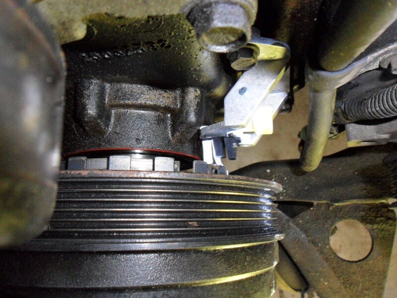

Ronnie Posted June 5, 2022 Topic Author Share Posted June 5, 2022 The new CPS arrived yesterday from Amazon. I installed it this morning. The engine fired right up and ran like it should. I was a little surprised at what happened. The plastic center section of the CPS had partially broken away allowing the magnet inside to fall out. (photos below) That explains why I lost both, 3X and 18X CPS signals at the same time. The magnet had stuck to the shutter ring but didn't damage it. I was lucky. I used my battery powered impact wrench to remove the crankshaft bolt. It had to hammer a while to break it loose. I put the bolt back in with blue Loctite and let the impact wrench hammer to get it tight. No, it's not up to spec but I don't think it will come loose. 2 Link to comment Share on other sites More sharing options...

Ronnie Posted June 5, 2022 Topic Author Share Posted June 5, 2022 12 minutes ago, DAVES89 said: Were the directions I wrote helpful? Yes, very helpful. I did use the new bracket that came with the Delphi CPS. The new CPS didn't seem to fit the old bracket as well as it did the new one. I did use the business card. I didn't completely understand how you folded the T shape so I came up with something similar (photo) and it worked well. As always, I took lots of photos. 🙂 All the help I got from everyone is appreciated. Link to comment Share on other sites More sharing options...

DAVES89 Posted June 5, 2022 Share Posted June 5, 2022 Glad it runs good, but I think your gap might be a bit too much. I meant for the card to slide along the shutter gate and the first gap on the Sensor. How was it to remove the bracket? I had a hard time so just left it and installed the new sensor in the old bracket. Link to comment Share on other sites More sharing options...
Ronnie Posted June 5, 2022 Topic Author Share Posted June 5, 2022 5 minutes ago, DAVES89 said: but I think your gap might be a bit too much. I meant for the card to slide along the shutter gate and the first gap on the Sensor. Do you think I will have a problem? I started the ring in the sensor from the top and then crawled underneath to make sure it was aligned before tightening the pinch bolt. I'm sorry, I still don't understand what you are trying to tell me about the card. Did you put it in the gap that the ring with all the notches goes in or the one that I used that only has three notches? The bolts came out of the bracket easy. I had to grasp the bracket and rotate it from side to side as I pulled out on it to get it off the guide pin. It does fit on the pin tightly. Link to comment Share on other sites More sharing options...
DAVES89 Posted June 5, 2022 Share Posted June 5, 2022 I used one thickness of the card and slid it closest to the crank shaft Like I said if you are running good you're probably good. 1 Link to comment Share on other sites More sharing options...
DAVES89 Posted June 5, 2022 Share Posted June 5, 2022 I'll try to explain it again. After I got the balancer on I slid a business card strip down the sensor and the gate closest to the crankshaft. It slid straight through and landed on the ground. So I made another one looking like a tee to stop it from sliding through. The I crawled under the car and snuggled the sensor up to the card/gate and tightened it down. Link to comment Share on other sites More sharing options...
Ronnie Posted June 5, 2022 Topic Author Share Posted June 5, 2022 You didn't fold the card so it sandwiched the metal shutter ring in between it like I did? I folded the card in the middle as shown so it would wedge into the first gap in the sensor. Then I folded the top edge of the card over so it would hook on the left edge of the sensor and keep the card from falling down. The folded card wrapped around the metal shutter ring as it slid in to center the gap on each side of the ring. I think I'll be OK. Time will tell. 🙂 Link to comment Share on other sites More sharing options...
DAVES89 Posted June 5, 2022 Share Posted June 5, 2022 Okay I see what you did. You are good as I see only one business card thickness on each side and a fold to not drop through. Link to comment Share on other sites More sharing options...
