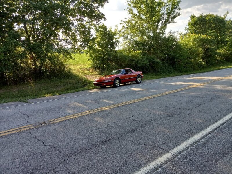

Ronnie Posted May 29 Topic Author Share Posted May 29 24 miles. Right out in the middle of nowhere with nothing in walking distance. Here is what I see in both directions. Link to comment Share on other sites More sharing options...

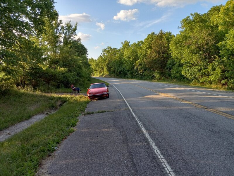

Ronnie Posted May 30 Topic Author Share Posted May 30 2 hours ago, ship said: Ronnie, very sorry to read of your dilemma. Have you had a chance to check out what caused the problem? It was an ordeal. You might could say it was the perfect storm. It was a holiday weekend when tow truck drivers didn't want to work, and it quit in the worst possible spot. Only good thing was the shoulder of the road was wide and I could get the Reatta out of the road. I talked to a friend this morning and told him my story. He is a retired nuclear plant operator. He said where the Reatta quit is just across the river in the nuclear plant's "exclusion zone" where there is nothing allowed for a few miles around the plant but fields to grow corn for the deer to eat. I was wondering why I could see red flashing lights in the distance once it got dark. 🙂 Below is a photo Heather took of what we could see when we looked behind where we were sitting. I've not done anything this morning to find out what is really wrong. It will probably be tomorrow before I do. It has no spark at the coils. I replaced the ICM/Coils (thanks Daves89) with some I had in the trunk right there in the side of the road and it didn't help. I'm guessing the crank position sensor is bad. I hope it is that simple to fix. 1 Link to comment Share on other sites More sharing options...
