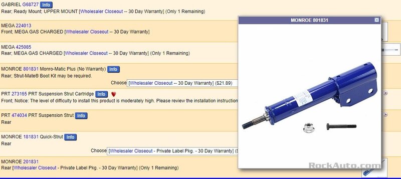

Ronnie Posted October 11, 2022 Share Posted October 11, 2022 I looked for a strut that might be close enough to work on a Reatta with just a little modification. The closest thing I could find was a rear strut for a 1996 Buick Regal. Only problem is they are being discontinued to. Link to comment Share on other sites More sharing options...

Ronnie Posted October 11, 2022 Share Posted October 11, 2022 3 hours ago, Philbo said: I looked up that strut for the reagal and it looks like it is an insert. If I am looking at the right one. Look up on RockAuto a 1996 Regal, Monroe 801831 rear strut. I don't have any specs but it looks like a front strut without the spring perch. Bottom end would need to be modified if other specs would work. They have them on closeout right now for only $22. Link to comment Share on other sites More sharing options...
Philbo Posted October 12, 2022 Share Posted October 12, 2022 46 minutes ago, Ronnie said: Look up on RockAuto a 1996 Regal, Monroe 801831 rear strut. I don't have any specs but it looks like a front strut without the spring perch. Bottom end would need to be modified if other specs would work. They have them on closeout right now for only $22. The extended length is 3.5 in shorter on that one than the reatta's the travel is actually slightly larger though. One plus it has going for it is it appears to have the same machining on the rod to accommodate the reatta's upper mount. Link to comment Share on other sites More sharing options...
