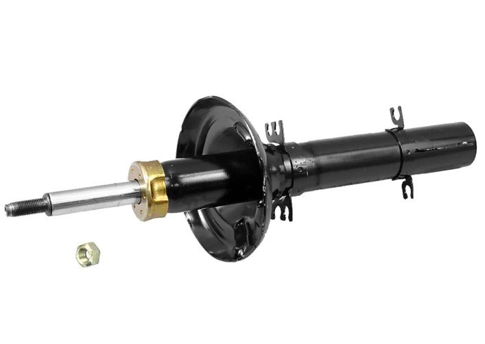

Philbo Posted October 4, 2022 Share Posted October 4, 2022 On 10/1/2022 at 12:03 AM, Ronnie said: I thought lukehemstreet would post his video but not happened so far. Not sure, but I think this is the video in question: I wanted to do a similar approach but maybe find another part that you don't have quite so much to cut off. From the Monroe chart I share d before, the reatta uses the B8 style. Was hoping to sift through and see if there is a B3 or maybe a B6 or B7 exists with similar dimensions. Link to comment Share on other sites More sharing options...
Philbo Posted October 4, 2022 Share Posted October 4, 2022 For example, here is a B4 style that is very similar specs to the Reatta part number. Only thing is it does not give a housing diameter or the diameter of the shaft Reatta part Potential substitute (with some grinding) What said potential substitute looks like I would like to try to get the data from the PDF into a spreadsheet so it could be sorted by dimensions and housing type. Maybe narrow down to a couple options and try to confirm the other dimensions somehow. Link to comment Share on other sites More sharing options...

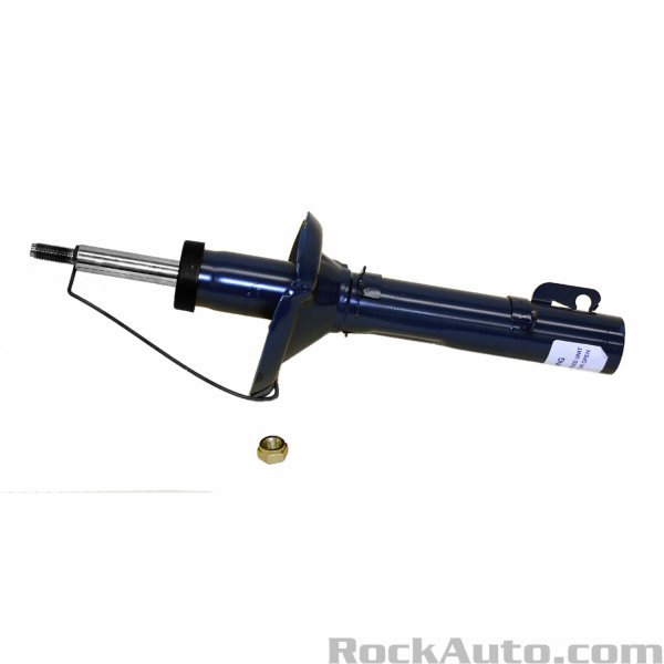

Philbo Posted October 4, 2022 Share Posted October 4, 2022 Maybe another option? https://www.rockauto.com/en/parts/monroe,72549,strut,7584 Link to comment Share on other sites More sharing options...
