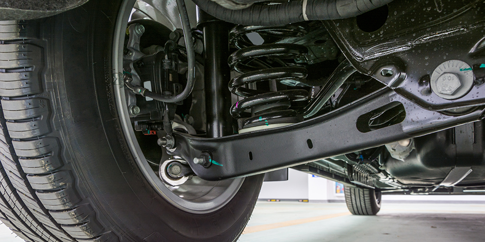

Ronnie Posted July 23, 2022 Share Posted July 23, 2022 I wonder if there might be another approach to solving the rear strut problem. The strut serves two purposes. Keep the rear wheel in vertical alignment as the wheel goes up and down, and control the ride of the car by dampening the rear control arm as it moves up and down. I don't remember anyone saying they had to change rear struts because the rear wheels were out of alignment. Isn't the primary reason the rear struts usually get changed because they lose their ability to properly control the the rear wheel causing a rough ride? In other words, the struts lose their internal dampening ability because the piston seals and valves go bad when they are worn out. Maybe we should find a way to ADD a standard shock absorber between the control arm and the strut tower as a damper to give a smooth ride without removing the old strut. I have been laying under my Reatta looking at the rear suspension and it looks like it might be possible to do that without a lot of fabrication. Similar to the way the shock is mounted in the photo below. The coil spring shown in the photo isn't needed on our Reattas because we have the transverse leaf spring that holds the weight of the car. 1 Link to comment Share on other sites More sharing options...
Guest Posted July 23, 2022 Share Posted July 23, 2022 3 hours ago, Ronnie said: I wonder if there might be another approach to solving the rear strut problem. The strut serves two purposes. Keep the rear wheel in vertical alignment as the wheel goes up and down, and control the ride of the car by dampening the rear control arm as it moves up and down. I don't remember anyone saying they had to change rear struts because the rear wheels were out of alignment. Isn't the primary reason the rear struts usually get changed because they lose their ability to properly control the the rear wheel causing a rough ride? In other words, the struts lose their internal dampening ability because the piston seals and valves go bad when they are worn out. Maybe we should find a way to ADD a standard shock absorber between the control arm and the strut tower as a damper to give a smooth ride without removing the old strut. I have been laying under my Reatta looking at the rear suspension and it looks like it might be possible to do that without a lot of fabrication. Similar to the way the shock is mounted in the photo below. The coil spring shown in the photo isn't needed on our Reattas because we have the transverse leaf spring that holds the weight of the car. The only draw back is you loose movement of the hub because of where the leaf spring supports the a arm?? Almost need to find a suitable straight axle rear sub frame??? But I would love to put tubular a arms on !!!! I'm not a engineer but maybe there are in the Forums??? Maybe use a old corvette rear end it's similar to the Reatta's suspension?? Sorry for rambling but I love this kind of discussion.!!! Link to comment Share on other sites More sharing options...
Ronnie Posted July 23, 2022 Share Posted July 23, 2022 I was thinking of a lot simpler solution, like putting some brackets on the existing rear suspension to mount a shock that is readily available. Next time I have the rear wheel off I'm going to take a look to see what I think might could be done. right now it is driving time in Tennessee and I don't want to have to work on anything on my Reatta unless I have to. 🙂 Link to comment Share on other sites More sharing options...
