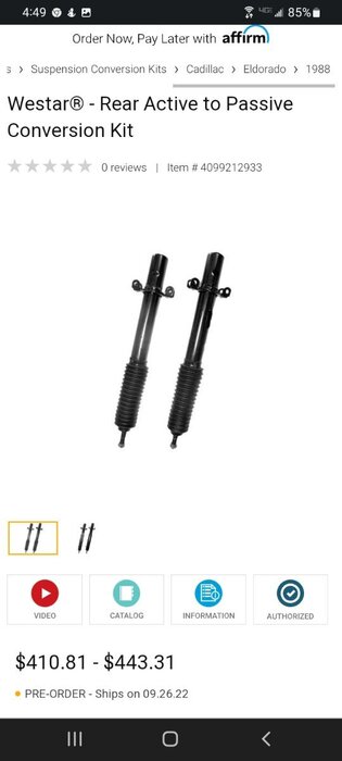

Guest Posted June 28, 2022 Share Posted June 28, 2022 Looking on internet today found pre order rear struts for 1988 Eldorado. I don't know if they will fit ?? Link to comment Share on other sites More sharing options...
2seater Posted June 29, 2022 Share Posted June 29, 2022 I would guess that they would work as the Eldo was an "E" body platform, but they seem a bit spendy. Strange the ad pictures them upside down although I guess it doesn't matter. Link to comment Share on other sites More sharing options...
Padgett Posted June 29, 2022 Share Posted June 29, 2022 Same Monroe 71801 as Riviera. There's one born every minute. Link to comment Share on other sites More sharing options...

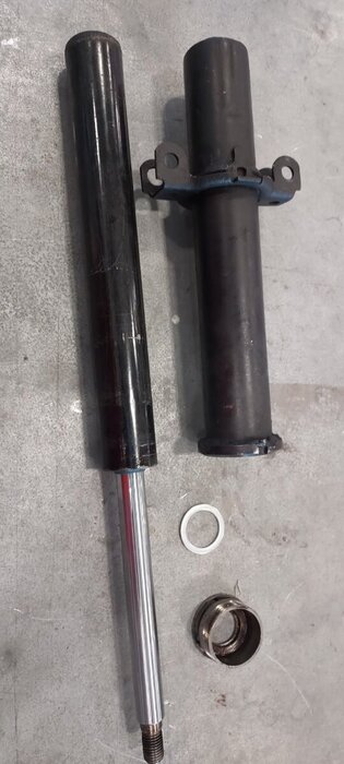

Guest Posted July 2, 2022 Share Posted July 2, 2022 (edited) Update, all materials showed up yesterday.. Going to machine shop on Tuesday... Once everything is done, I will video it., I don't believe this should stress anyone out to do!!! You should be able to do locally... I just wanted to say thank you Ronnie for being up beat!! I believe I'm holding accountable for information given but I don't tolerate people unwilling to listen.... The end of the day we all love our cars or the people who does!!! I'm still a muscle car guy that loves his childrens...updated machine shop not done with the weldable nut yet but I thought I would share where we are at. Edited July 14, 2022 by Sam car Update Link to comment Share on other sites More sharing options...

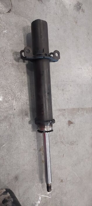

Guest Posted July 22, 2022 Share Posted July 22, 2022 Went to machine shop this afternoon, got 1 done!! Link to comment Share on other sites More sharing options...
DAVES89 Posted July 22, 2022 Share Posted July 22, 2022 (edited) Looks great! Can you give us the contact name of the shop so we could have them made if we want? Can you tell us the price for this? Also a parts list of what to order? Edited July 22, 2022 by DAVES89 Link to comment Share on other sites More sharing options...

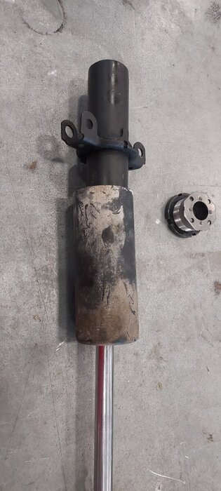

Guest Posted July 22, 2022 Share Posted July 22, 2022 12 hours ago, DAVES89 said: Looks great! Can you give us the contact name of the shop so we could have them made if we want? Can you tell us the price for this? Also a parts list of what to order? Sorry for the delay. I bought off of Amazon uxcell M50x1.5 mm nut and took to local machinist to get the threads cut. He charged me 202.00 for 4 nuts to cut the threads, the rest I did myself. The gland nut that I posted that I used to center the nut when I welded it onto the strut body. But like I said you can buy different gland nut from Koni and use there universal strut cartridges (2 out of 4 monroe where flat out of box)and I still had to make adapter for the stem. With the Koni universal you wouldn't need that. I didn't approach them about doing the complete strut body , he charges 110 per shop hour and I'm at my spending limits on this project..But I figure he probably charge 10hours??? Just a guess. If you want I will call him Monday??? Link to comment Share on other sites More sharing options...
