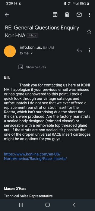

Guest Posted May 23, 2022 Share Posted May 23, 2022 Koni replied to my email, here is there response. Sorry. Link to comment Share on other sites More sharing options...
Guest Posted May 23, 2022 Share Posted May 23, 2022 (edited) I did follow-up with the question, if I give them dimensions if the could make some custom struts for us. Stay turn Edited May 24, 2022 by Sam car Additional reply from Koni. Link to comment Share on other sites More sharing options...

Guest Posted May 25, 2022 Share Posted May 25, 2022 (edited) It looks like koni 8611 1258race strut comes closest to factory and is adjustable, we just need make adapter make it fit tight in bore of old strut and use there racing insert gland nut. The next month I will try to fabricate a adapter. I think we can do the same for the front struts. I think this group can keep these car on the road for along time!!!🙂🙂 Sorry wrong part number should be 1259race. The strut body can't be more than 13 inches long. Edited July 24, 2022 by Sam car Wrong part number Link to comment Share on other sites More sharing options...
