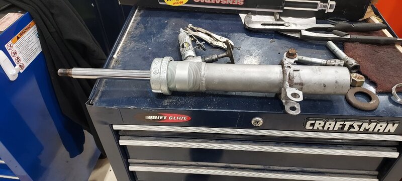

Guest Posted May 7, 2022 Share Posted May 7, 2022 Koni sells cut a strut option that you use original housing, (nice you tube demo) but I can't find a option to buy .. so I used monroe insert struts and kinda same concept. Link to comment Share on other sites More sharing options...
DPS.01 Posted May 7, 2022 Share Posted May 7, 2022 Looks like a very good solution. Can you share the part number of the Monroe insert that you used? Thanks. 1 Link to comment Share on other sites More sharing options...
Guest Posted May 7, 2022 Share Posted May 7, 2022 I used monroe 73267, you probably see if you local machinist can but together due to making adapter for the stem of the strut, I think I should have called around and try again for the Koni option. But so far the rides so much better. Good luck!! Link to comment Share on other sites More sharing options...
DAVES89 Posted May 7, 2022 Share Posted May 7, 2022 Sure looks like it would work, just have to come up with the sway bar bracket. But nothing a machinist can't make. Good work! Link to comment Share on other sites More sharing options...
Ronnie Posted May 7, 2022 Share Posted May 7, 2022 39 minutes ago, Sam car said: I used monroe 73267, you probably see if you local machinist can but together due to making adapter for the stem of the strut, I think I should have called around and try again for the Koni option. But so far the rides so much better. Good luck!! Could you post a photo of yours? 1 Link to comment Share on other sites More sharing options...
DPS.01 Posted May 7, 2022 Share Posted May 7, 2022 Thanks for the information. When you reference the adapter for the stem of the strut, is that because the drop in cartridge has a smaller diameter piston rod? Link to comment Share on other sites More sharing options...
Guest Posted May 7, 2022 Share Posted May 7, 2022 Link to comment Share on other sites More sharing options...
DPS.01 Posted May 7, 2022 Share Posted May 7, 2022 25 minutes ago, Sam car said: Nice work. Photo is worth a thousand words… Link to comment Share on other sites More sharing options...
Ronnie Posted May 7, 2022 Share Posted May 7, 2022 Sam, did you start out with cutting the bottom part off the Reatta strut like in Jon's photo below, OR did you cut off the top and add the pipe fitting to that? I can't really tell from your photo. Link to comment Share on other sites More sharing options...
Guest Posted May 7, 2022 Share Posted May 7, 2022 Yes I'm no proud of it but it works airbag it make custom airbag struts for our car but it's over 1500.00 a strut. And I used strut inserts not struts. I tried a couple of different strut and cut off spring perce. In total its been a ride to get to this point 2 months and this my teenager car so trying to make safe as possible. Good luck to all Link to comment Share on other sites More sharing options...
Guest Posted May 8, 2022 Share Posted May 8, 2022 50 minutes ago, Ronnie said: Sam, did you start out with cutting the bottom part off the Reatta strut like in Jon's photo below, OR did you cut off the top and add the pipe fitting to that? I can't really tell from your photo. Cut the top , on YouTube there is a good video on koni strut inserts. Yes it's a 2 inch pipe welded on the housing. I think since monroe will not support our cars Koni might be our best option..I emailed them last week but no response yet. Link to comment Share on other sites More sharing options...
Ronnie Posted May 8, 2022 Share Posted May 8, 2022 Just now, Sam car said: Cut the top , on YouTube there is a good video on koni strut inserts. Yes it's a 2 inch pipe welded on the housing. I think since monroe will not support our cars Koni might be our best option..I emailed them last week but no response yet. Thanks I'll check out the video. Yours may not look like a factory job but if it works that's better than anything the rest of us have came up with so far. You showed us it could be done. Thanks. Link to comment Share on other sites More sharing options...
