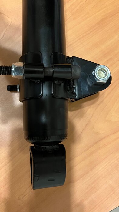

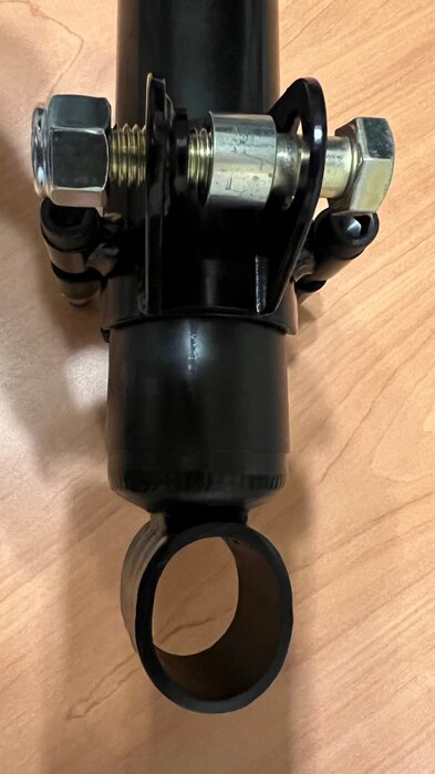

DPS.01 Posted November 15, 2022 Share Posted November 15, 2022 Final mockup of the assembly, with all modifications necessary (TBD upon final installation). Need to install, and do final sway bar bracket adjustments, then can do a concise write up as to one option for unavailable rear struts. 2 1 Link to comment Share on other sites More sharing options...
Ronnie Posted November 15, 2022 Share Posted November 15, 2022 It looks good. I hope it works. 1 Link to comment Share on other sites More sharing options...

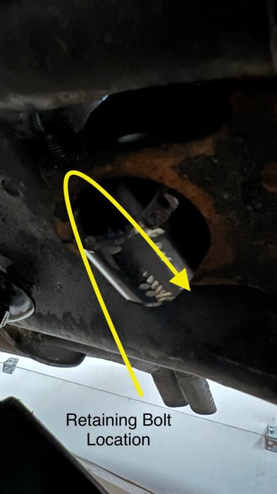

DPS.01 Posted November 15, 2022 Share Posted November 15, 2022 7 hours ago, jon L said: Where is your bottom mount There is no bottom mount. The strut is inserted directly into the knuckle, just as with the OEM strut. photo above is Cardone strut inserted prior to receiving the sway bar mounting clamps. (Shows sway bar in relative position to strut). photo above shows lower portion of strut extending below bottom of knuckle. The plan is to use a large diameter bolt as an additional safety measure because the clamping new strut in the knuckle by the pinch bolt is approximately 1/2 of that when using the OEM strut. see previous comments by Ronnie and others regarding insertion depth etc. Photo above shows top of strut attached to upper strut tower. 1 Link to comment Share on other sites More sharing options...
DPS.01 Posted November 15, 2022 Share Posted November 15, 2022 7 hours ago, Padgett said: Could we have a final parts list and sources please ? Yes, along with modifications needed, once everything is installed and finalized. At this point, the final mock-up of the strut with the sway bar clamp attached has not been installed on vehicle… work in progress, and may require adjustment / further modification. 1 1 Link to comment Share on other sites More sharing options...
jon L Posted November 16, 2022 Share Posted November 16, 2022 Your pictures leave a lot to be desired. Your explanation of the retaining bolt cannot be seen in your pictures. Link to comment Share on other sites More sharing options...

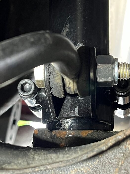

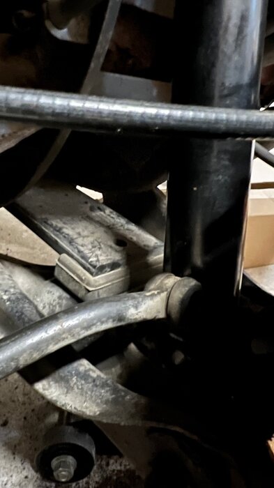

DPS.01 Posted November 19, 2022 Share Posted November 19, 2022 Just finished up on my 1993 Allante strut retrofit for the Reatta w/ sway bar attachment clamp. My 11 year old daughter and I took it on its maiden voyage… no squeaking / rattling, or other odd sounds. Very stiff ride, but I actually like it. Overall, I am extremely pleased with the results so far (10 miles)… the new rear struts did make it obvious that the front struts are overdue for replacement. Photos taken with car on the ground; after ~10 mile run in… Link to comment Share on other sites More sharing options...
Ronnie Posted November 19, 2022 Share Posted November 19, 2022 What I see so far looks good. Link to comment Share on other sites More sharing options...
Padgett Posted November 20, 2022 Share Posted November 20, 2022 And the throughbolt below the sway bar ? Link to comment Share on other sites More sharing options...
