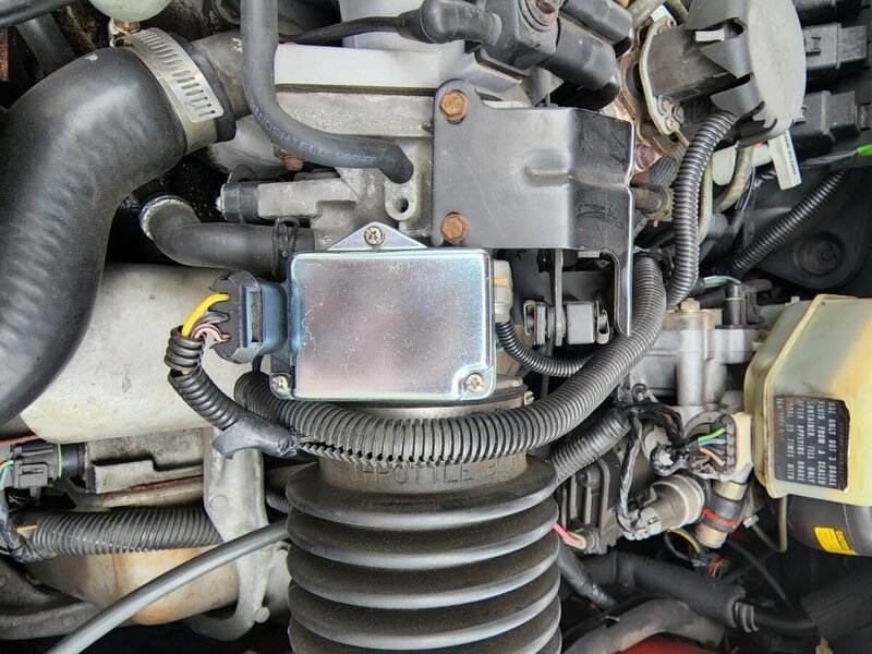

2seater Posted March 30, 2022 Share Posted March 30, 2022 Thanks for letting us know. If I have learned anything over the last few decades it is the glitches that are encountered seem to have new variants, much like the Covid situation. That is a rather peculiar looking MAF sensor? No numbers or markings or rebuild stickers, most unusual. If it gives any additional bobbles, I am betting the crank sensor or a wiring fault between it and the ECM or ICM Link to comment Share on other sites More sharing options...
DAVES89 Posted March 30, 2022 Share Posted March 30, 2022 Hope you have it fixed. But here is my "soap box" speech. One has to remember that all the Reattas are now at least 31 years old. One has to have known good working back up parts. They would be [but not limited to] MAF Sensor, Ignition Module/Coil Pack, Oxygen Sensor, Crank Sensor. Combined cost for those parts used MAF Sensor, Ignition Module/Coil Pack, and new crank sensor, oxygen sensor is less then $200.00. Far less then a tow charge, diagnostic charge, repair charge and loss of confidence in your Reatta. A number of us have been "helping" for 15 years or more and we know that these are the parts that fail. Please everyone consider getting extra parts, it's called investing in yourself. 2 2 Link to comment Share on other sites More sharing options...

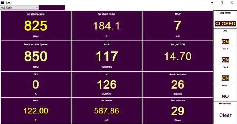

Padgett Posted March 30, 2022 Share Posted March 30, 2022 <rant> Older computer cars (GM started in 1981) need proper instrumentation. This means the ability to monitor many different things at once. Moates.net has everything you need. The only essential thing you cannot monitor on a computer is the rail fuel pressure, that takes a gauge. The display below is also being logged for later review.</rant> Link to comment Share on other sites More sharing options...

Padgett Posted April 18, 2022 Share Posted April 18, 2022 You mean "it is not telling the injectors to fire". BTW the "Engine Computer" is called the Engine Control Module (ECM) by GM. BTW the ICM (Ignition Contol Module) sends an RPM based signals to the ECM telling the injectors when to fire. The length of time the injectors fire (pulse width modulation) is determined by other sensors like the MAF (Mass Air Flow Meter). Does the tach jump when the injectors stop ? ED01 is the throttle position sensor (TPS) - if the TPS drops to zero the engine will stall, ED06 is the injector pulse width. Is either jumping around when the engine falters ? There is no substitute for proper information. Otherwise you are just throwing parts and money at it. 1 Link to comment Share on other sites More sharing options...
