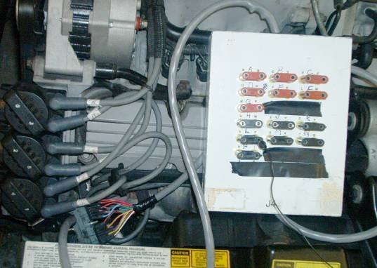

Padgett Posted February 21, 2022 Share Posted February 21, 2022 The ICM connector has very short pins. I always remove the sponge when reinstalling and the single screw does not tighten evenly. Try removing the sponge and tappong on the ends of the connector when tightening. I wound up building a break out box from scrap so I could monitor the ICM connections. Link to comment Share on other sites More sharing options...
