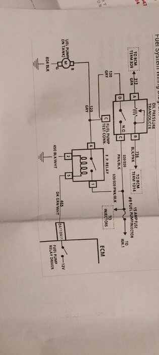

Schawya1 Posted October 7, 2021 Topic Author Share Posted October 7, 2021 There wasn't any pressure in the rail, just whatever residual fuel that was in there, but she starts up everytime and accelerates perfectly! Thanks again for everyone's help! 1 1 Link to comment Share on other sites More sharing options...
Guest Posted June 29, 2022 Share Posted June 29, 2022 I had long start on first start of day ended up being fuel pump relay. It had to get oil press before fuel pump would run. Kept hearing a pump running when I turned on ign, that ended up being abs pump. Link to comment Share on other sites More sharing options...
Padgett Posted June 29, 2022 Share Posted June 29, 2022 (edited) Yes the lack of the approx. 2 second shot when you turn the key on can lead to long cranks. Was even a TSB on it. A 12v light on the green wire will tell you exactly what is going on. Edited June 29, 2022 by Padgett 1 Link to comment Share on other sites More sharing options...
