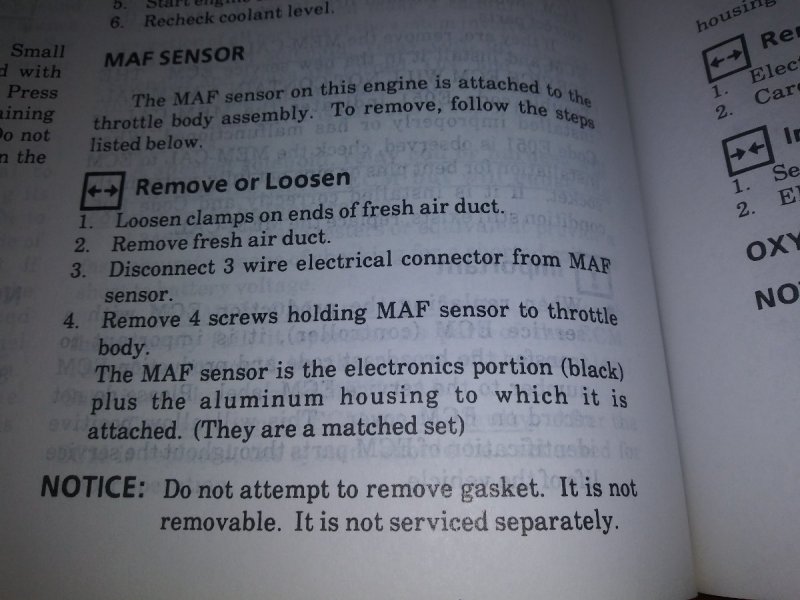

Philbo Posted September 17, 2021 Share Posted September 17, 2021 @david scitern Out of curisity did you replace just the MAF sensor itself or the whole MAF assembly? I happened to notice in my manual when I was doing my intake gasket that it says the sensor and the aluminum housing is a matched set. I wonder if that had anything to do with the issue. Link to comment Share on other sites More sharing options...
Ronnie Posted September 17, 2021 Share Posted September 17, 2021 14 minutes ago, Philbo said: I happened to notice in my manual when I was doing my intake gasket that it says the sensor and the aluminum housing is a matched set. Good info. I didn't know that. Link to comment Share on other sites More sharing options...
