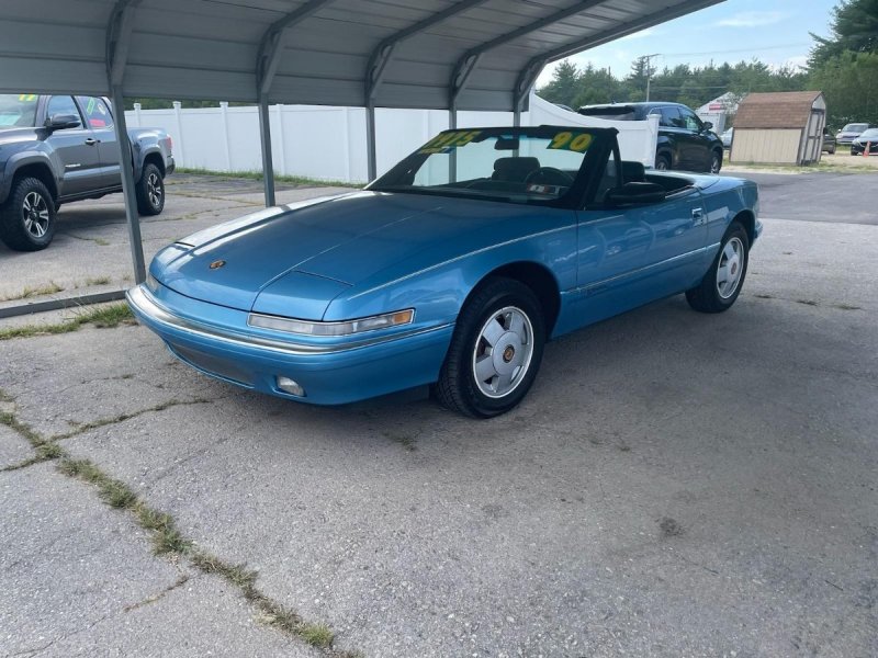

RLTherio Posted September 3, 2021 Share Posted September 3, 2021 (edited) Back in June, I found a 1990 Reatta for sale at a used auto dealer placed a deposit on it. Thanks to this forum I learned a lot especially how to access trouble codes from the electronic climate control module. It had an E041; camshaft position sensor trouble. The dealer said they would take care of it. Last Tuesday, I paid the remainder of the cost, I was told there was a rattle in the engine and the garage that repaired the camshaft sensor problem needed to install another oil pan. Wednesday I received a call from the dealership that the rattle turned into a bearing knock. I was given a choice of a complete refund or accepting the car as is with a five grand as well; half of the cost. It was a Maui blue with a white convertible with just over 59,500 miles in very good condition. Two friends of mine that are automotive technicians told me to walk away. The dealership will probably send the car "as is" to an auction to be sold. The car is located in southeastern New Hampshire. Edited September 3, 2021 by RLTherio Link to comment Share on other sites More sharing options...

RLTherio Posted September 3, 2021 Topic Author Share Posted September 3, 2021 I just finished talking to the mechanic that diagnosed the noise, he said it sounds like a bad alternator bearing rather than a bearing knock. He also replaced the oil pan and found brass metal flakes floating in the oil. So at this point I am going to just walk away, although I hate to part with such a beautiful piece of Buick history. Link to comment Share on other sites More sharing options...
