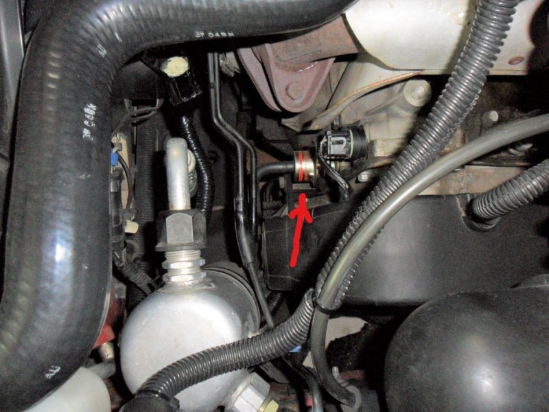

Check the vacuum modulator on the transaxle. Pull the vacuum hose and check for fluid being sucked into the intake. It does smell in the exhaust when that happens and will reduce the fluid level in the trans. as well. If this only happens at startup after sitting overnight, it may just be a little leakage in a valve seal which dissipates when warmed up.
Look on the drivers side. Red arrow points to the location of the modulator valve. Yours may look slightly different. Mine is an aftermarket. The original modulator is bigger.

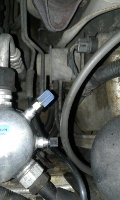

This is what's there. To put it shortly, it's pretty big. It seems to be on pretty good and I couldn't get any wiggle out of it when I touched it. The R134a can be seen here too.
There is a 10mm bolt on the underside that has to be removed. But that is it.
Great pictures guys. I was suggesting just pulling the vacuum hose to see if there is evidence of fluid in the hose. No need to remove the modulator itself unless fluid is found in the hose. Sorry for the unclear suggestion.
