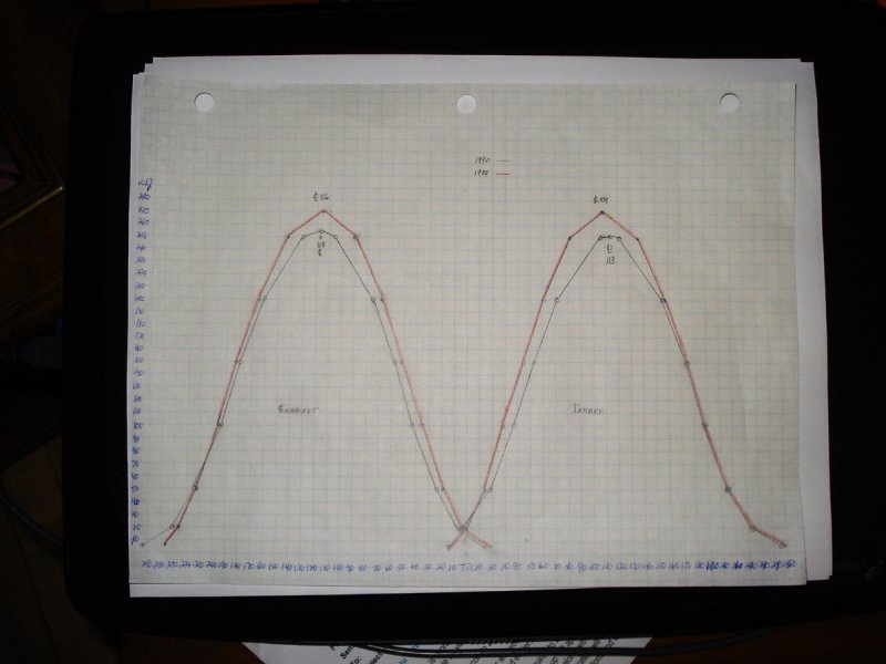

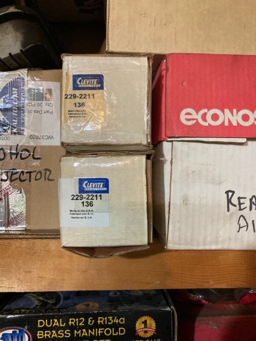

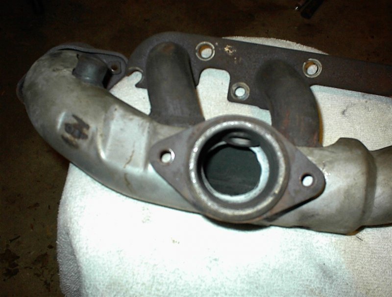

2seater Posted April 12, 2021 Topic Author Share Posted April 12, 2021 I realized I failed to include photos of some basic items, referred to in the previous posts in this thread. The rear exhaust manifold restriction is well known, and removing it costs a certain amount of labor and it depends how innovative you are doing it in place or on the bench, which is what I would recommend. Bear in mind the exhaust is a 400 series stainless steel that does rust and is magnetic, but it is tough and not the easiest to grind out. I found I could use a good quality hole saw, 2 1/16" I think, and use the outlet as the guide and cut everything away, including the excess threaded boss for the O2 sensor inside the pipe. It seals on the outside just like a spark plug. Actually it is the same size and thread as an old style 18mm spark plug. If you do it with the hole saw, use lots of lubricant. I have noted a slight deepening of the exhaust tone with no other changes, your results may vary. The first photo is from 1998 These are the aftermarket replacement cams with the 1988 lift and duration. They are an exact replacement however, the flange at the front that bears against the block is thicker and the spacer washer used on the later cams should not be reinstalled or chain drive misalignment will occur. This is also the hand plot I did of the 1988 and later model LN3 cam which I have posted several times in the past but I am including it again here. The taller and wider lobes are the 1988. Lastly, I found a critic lurking in the background but is unmasked here. 1 Link to comment Share on other sites More sharing options...
