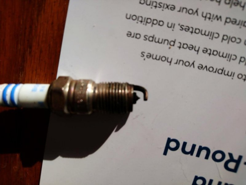

As I stated before, I just recently bought this car and it was running rough so decided it was time to look into things.  I pulled this plug from cylinder #1 and now I know why!  naturally, all matter of dire answers were running through my head so I'm greatly relieved.  Tell me, have you ever seen such a worn out spark plug?
What brand is it? That is the way a Bosch Platinum plug electrode normally looks. Can't tell by the photo much about amount of carbon build up on it.
They're Bosch but, unlike the one pictured, only the center of the electrode remains.  My new ones are AC Delco and the electrodes are the usual, think Bosch is a better choice?
I like ACDelco but most name brand spark plugs are good. Are the electrodes covered with soot like it appears in your photo or is that just a shadow?
Yes, covered with soot, I'm assuming it because of poor combustion.
If you're concerned that the car is burning oil, I've seen fouled plugs before and this one doesn't look like that, just a little soot.
When I see that soot it makes me wonder if it's caused by not enough spark or too much fuel.
Well, I haven't had it out on the road yet but, because of the condition of the old plugs, I'm betting on not enough spark, time will tell.  There's also the issue of it not being driven for two years, the gas could be bad.  I threw in a bottle of dry gas and thinking I will put in some Sea Foam detergent too just as an added measure, the tank is about half full.
It does look like a fine wire type plug. I haven't ever seen a conventional center electrode reduced to that shape. Usually it erodes to a rounded shape? I have seen the side electrode missing all together. Our waste spark ignition fires each pair of plugs in opposing directions so if a platinum plug is desired, it should be double platinum. JMO  I don't put enough miles on, plus I change engines, so I just use conventional type plugs. Again, JMO
If changing plugs cures the roughness, I would run the car for a while to give it a chance to clean itself up. If there has been a lot of idling and short runs while trying to evaluate the issues, the plugs likely will be less than ideal.
