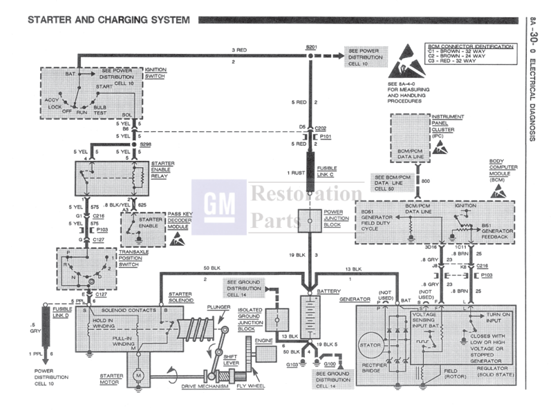

  4. Here is the 91 Starter and Charging System. A service manual is a an extremely valuable tool for these cars if you are going to do the work yourseld.

  9. I was wanting you to do that because if the lights went out when you turned the key it would mean you had a bad connection to the battery. Since your lights don't dim or go out that tells me there is a problem in the circuit that activates the starter. I hesitate to offer to much help on a '91 because there a lot of differences from earlier models and I've never worked on a '91. From what I've read here so far, your problem could be the theft deterrent system locking out the starter, a bad ignition switch or park/neutral safety switch as 2seater said. Below is the path (yellow) the circuit takes if your '91 is like earlier models. Note the starter interrupt relay in the circuit. It is what keeps the starter from turning if the VATS is the reason it won't start. Assuming the '91 is same as other models, I would do my troubleshooting at the transaxle position switch to determine if the starter is the problem or the other things mentioned.
