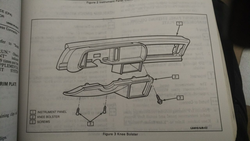

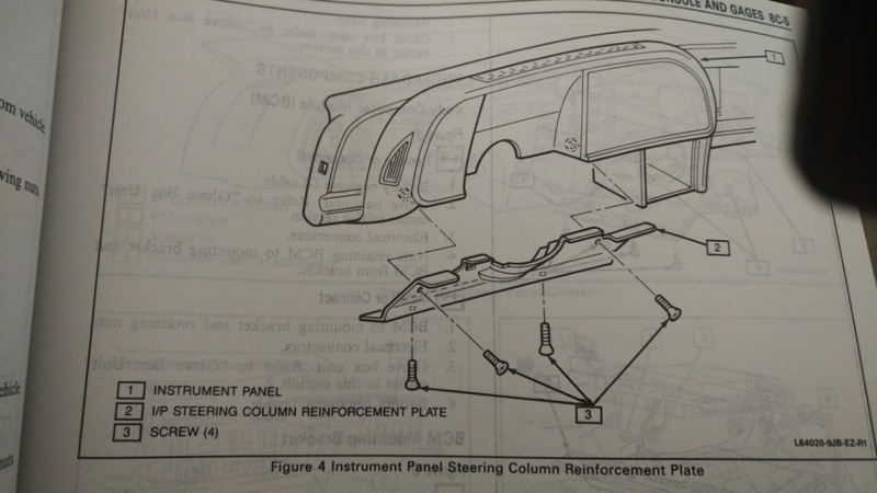

I unfortunately cannot find those photos. I think I took them with my camera instead of my phone and I cannot find that memory card. However I did find these. These were the only two pieces of trim I had to remove to get to them. Then you have to lie awkwardly on your back and look up to the passenger side of the steering column. Any long screwdriver or extra long nose pliers etc. that you can employ to help you is good. If I recall I could squeeze my hand up and touch them. I will also say, the seats are really easy to remove and re-install if you wanted to do that to give yourself more room to lie down to work.2 points
