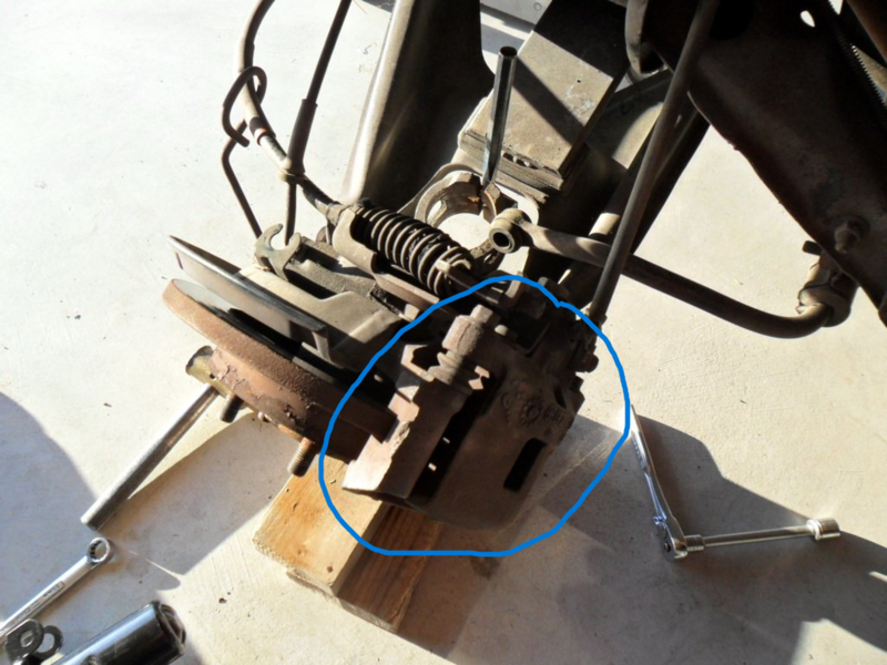

  3. Ah ye sorry I see the caliper now. Thanks for your tips!

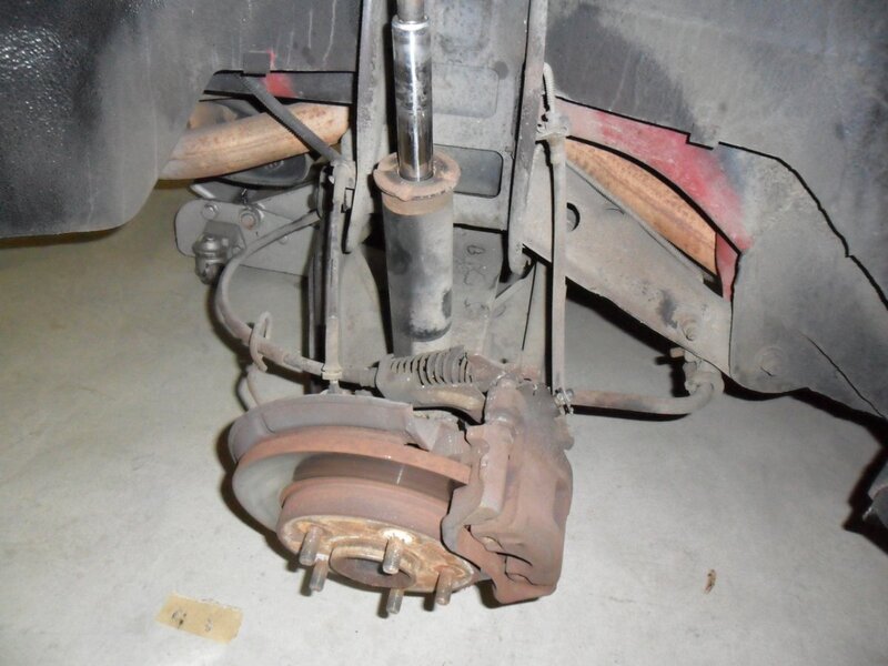

  4. Just a case of can't see the forest for the trees. It's the rusty thing inside the blue circle. 🙂 Can't help with finding a sway bar bushing.
  5. I put blocks of wood under the bottom to limit how far the knuckle can lean out when the strut is removed. That prevents putting a strain all the hoses and cables attached to the caliper.
  6. Great thanks, I won't remove the calipers and will be cautious the the ABS wheel sensor leads. I replaced all 5 rubber brake hoses. While doing so, I noticed the plastic insulation on parts of the ABS wheel sensor coax leads was crumbling. I just peeled off the crumbled plastic, and recoated the bare wire with 3 coats of black silicone sealant which should protect the leads without having to remove them for replacement. Maybe not as pretty as brand new leads, but should do the job and be durable.
