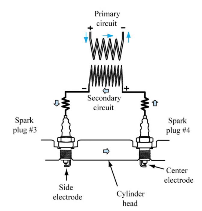

  2. This is the circuit diagram for a four cylinder but the principle is the same. It appears the current flow is in series where one plug fires forward and the mate fires in reverse. I always have a hard time getting my head around the fact that the plug center and side electrodes are isolated from each other and the only way for current to flow is by jumping the gap, no matter which way it is going. I would guess if a hypothetical runner can jump a ten foot gap, they could also jump a five foot gap, and more easily? But what if there was a series of gaps to jump, maybe fifty or a hundred? šŸ˜–
