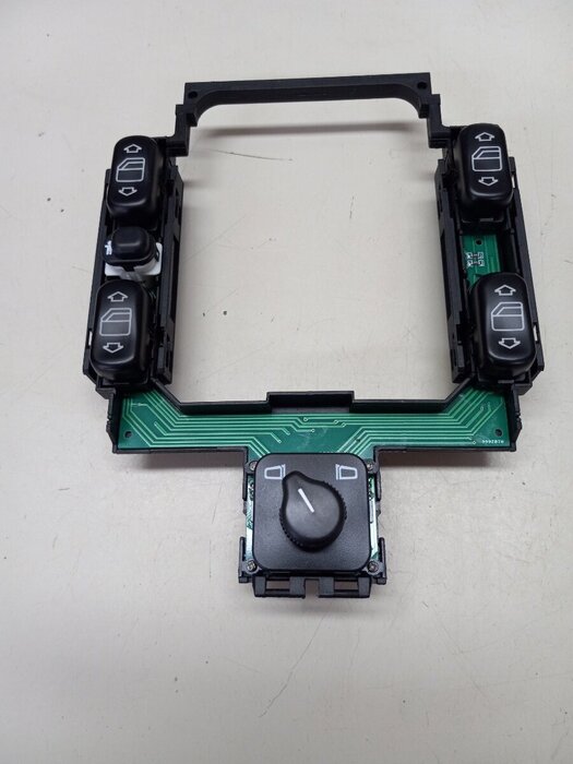

  4. The power mirror knob (bottom in photo below) was broken off so I installed a new switch module today that also includes all the power window switches. Didn't even need any tools. The center console top just snaps out of the console and slips over the shifter. Then you just slide 2 locking tabs made into the back of the switch module to remove the module from the console top. On the back of the module are three small wire connectors to unplug. Reverse the procedure and your done. Why can't GM make things so simple? Total cost of the new (Chinese) module was $34.92 from Amazon. I think Mercedes dealer price is nearly $200.00. Hope I don't have to buy any parts from the dealer.
