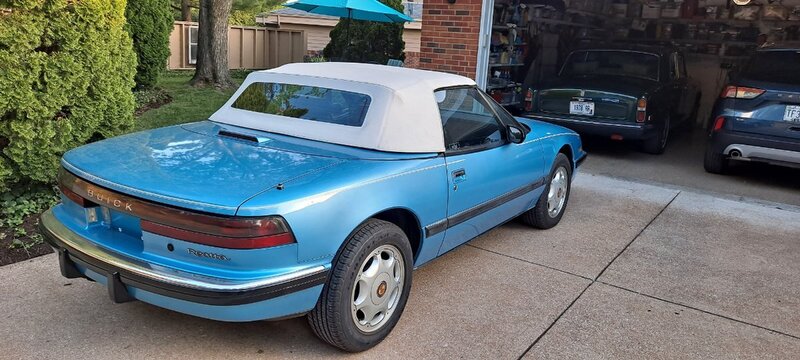

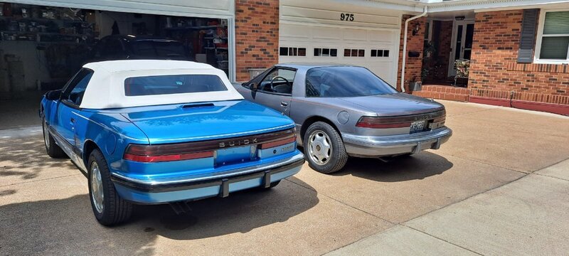

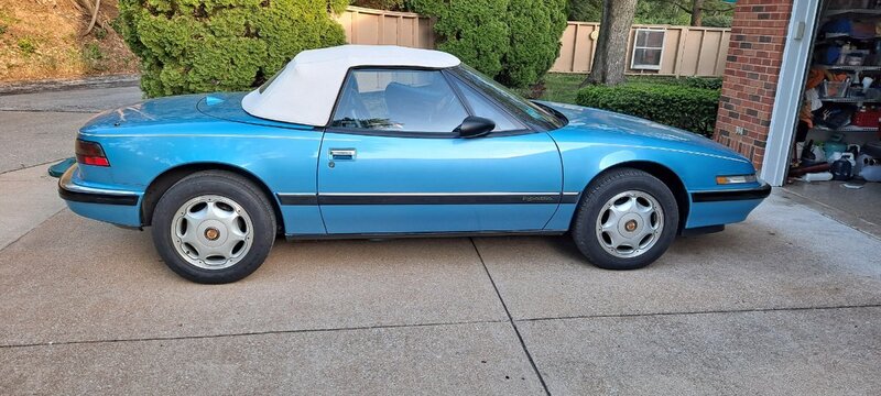

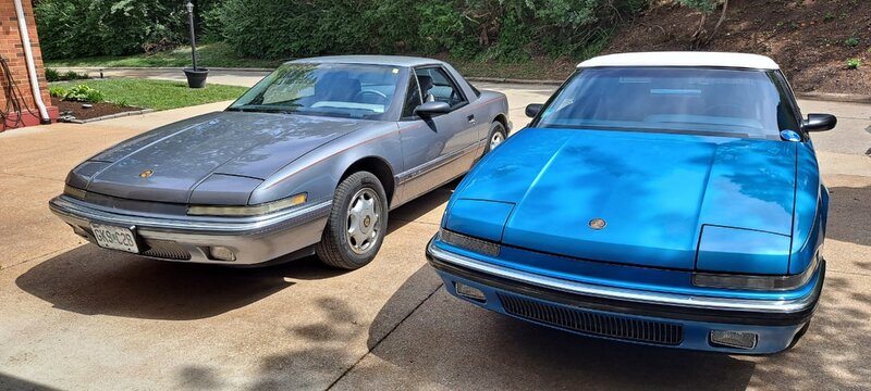

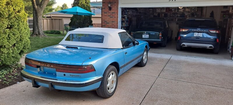

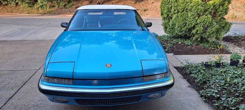

  1. A 1991 Maui Blue Reatta showed up at my door Sunday May 28,2023. My 91 Gunmetal Gray Hardtop wanted a Topless Beauty to share space with. Car has 12,750 miles on it and in excellent condition. Problems, radio has no output, lights all light up but no sound, no sound from the cassette either. The change dispenser is missing the guts, the driver vent has a broken tab that allows you to turn off the vent, the right side sun visor clip is broken, tires are 8 years old. I checked the radio fuse on the drivers side panel and it is okay. I checked the big service manual, but keep getting lost in it. Is anyone willing to give me some sage advice on where to look for connectors/fuses/etc. I spent my working life repairing radios and radars, and still remember how to use a multi meter, and read normal schematics. These in the Service Manual will take me a bit to get use to. thanks to all of you. Jim
