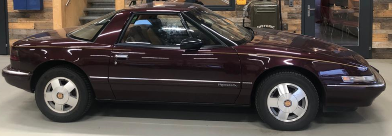

  4. Great looking car. I like the color. Reattas are pretty much unicorns.
  5. Here's my 1989 Reatta. Only one I have ever seen in real life. These cars are pretty much unicorns over here in Europe.
